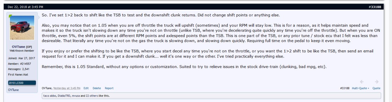

    OVTune
    OVTune [OP] Well-Known Member
    Mar 27, 2017
    #214557
    8,112
    OVTune
    Not only did I acknowledge it, I explained it, and said if anyone wants it to shift different to email.
    I've had several messages from 4x4 trucks that they actually prefer it shift this way, and once again, it was done so to alleviate the clunking.
    Specifically, it was done to help reduce or eliminate the clunk and or "bucking" when coming to a stop in 1rst gear when the truck downshifts. It is more than just a clunking it feels like, for a moment something pops in the back of the truck. This is from the transmission harshly going into 1rst gear.
    Even more specifically, which I have explained in great detail, the same tables that control the gears going up also control the gears going down so anything you want the truck to do going DOWN must also remain when going UP. So, to tune the 2 > 1 DOWN, also directly affects 1>2 UP.

    OVTune
    Mar 27, 2017
    #214557
    8,112
    OVTune
    I planned on dropping off any remaining orders tomorrow morning, but I dont know when they will arrive to people.
    I think part of it is the fact that people have been on the TSB and 1.04R for so long they think this is how the truck should drive, or it's the most ideal way for it to drive. (might be for some, if you have a 4x2 with no weight, stock tires, 87 octane)
    However, the TSB, and 1.04R files still have things that need corrected that were focused on with 1.05.
    1. The lack of immediate power/ response in low rpm.
    2. The lack of ability to maintain gear, speed, response on the highway.
    3. The rapid deceleration whenever you are not on the throttle due to the shift schedule. - This is a huge issue for trucks with larger tire or weight, it compounds the effect, making the truck feel like it weights 10,000 lbs.
    4. The shift dancing between 40 and 50mph. (This is still some-what present on 1.05 due to how the shift tables are now designed, it is done so for a specific reason - So that the truck will NOT get stuck in 4th gear on the highway. As a result / side effect, the truck may, depending on accelerator position, change from 4th to 5th in that medium speed range 40+ to 50mph.
    5. The upshift on coasting that drops the engine under 1000 rpm (when going about 40mph)
    6. useless cruise control
    7. The use, or lack of use, of the torque converter locking
    8. Getting stuck in 4th while requesting aceleration on the highway.
    9. Less than desirable MPG.
    etc.
    1.05 is vastly different than the TSB or 1.04r. It may just be too different..
