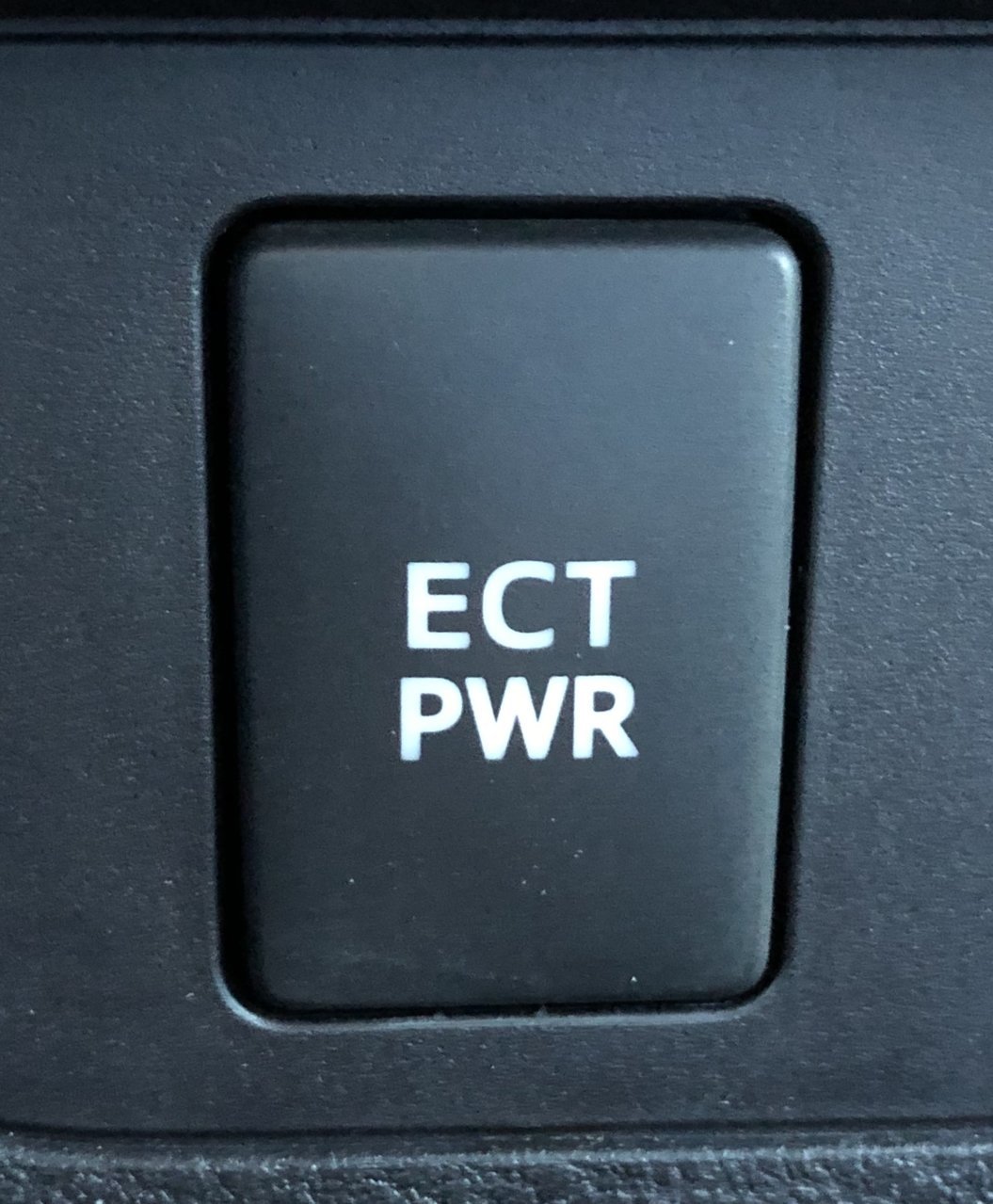

    Update
    I just logged 40 miles on the highway and I must say that this little button will change the way you feel about 1.05. I also highly recommend that everyone give it a shot before giving up the option of ECT in Dmode for the optional gear lock feature.
    Until 1.05, ECT and I have had a love-hate relationship. I loved the throttle response, but hated the way it seemed to highlight the negative features of Toyota’s TCU mapping. In my opinion, it held gears too long and downshifted to 4th prematurely when at highway speeds during calls for acceleration. It also didn’t like to shift into 6th gear unless I was at 75-80 under no load.
    Now, I think this magic button really shines a light on how significantly @OVTune EPROM tables have improved the drivability of the AT Tacoma. I have a feeling @mesojdm will need to do a massive run on his ECT always on mod.
    @OVTune, am I experience a placebo effect or does your EPROM make ECT a more usable feature? Either way, it’s freakin AWESOME!!!

  7. Dec 23, 2018 at 7:50 AM

    Ect is fun. My truck drives better with it on.

    I also like this button when i am in a hurry.
