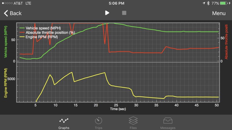

    Here's me flooring it and holding it down until
    80ish mph. Throttle never goes past 80%. It does some funky shit in first gear.

    It'd be cool if you could add ignition timing as well..

    I'll see what I can do on my way home from work tomorrow

    The OBD never shows 0% or 100%. The lowest it goes is like 15% and the highest is probably ~85 (looks higher than 80 in your graph). My gen1 was the similar. I guess they figure the throttle plate obstructs ~15% of the throttle body even when it's "fully" open.
    That it drops to 50% at low rpm is not a problem, IMO. Like I said earlier, no matter how wide you open the throttle the engine can't use much air at 1500 rpm. That it doesn't reach ~85 closer to 6k rpm is troubling. It's just not taking you seriously until 2nd. Maybe it has to do with traction control? ECT or no?
