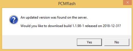

    Downloaded the files per instructions: Dongle drivers, Tactrix Drivers, and Flash Software.
    When opening PCMflash, I get the following prompt.
    "An updated version of the software was found. Would you like to download build 1.1.98-1 released on 2018-12-31?"
    If I click yes, it takes me to www.PCMflash.ru which is a Russian website.
    What is happening???

    OVTune
    You can update if you want to, it's not required.
    2019 AT files are ready (sending today)
    Idle fix for ECUS : 04B04, 04A61 (for people with the issue) also

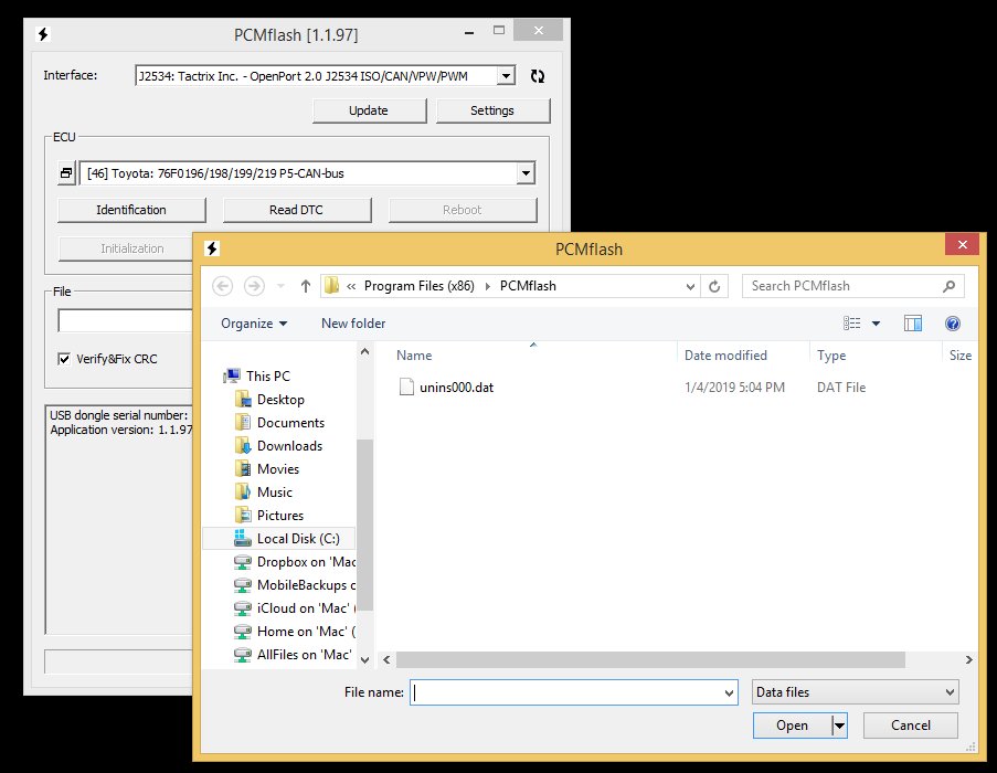

    Thanks Mat. Next question. What do I do when the TUNE FILE.bin is not there?

    Bottom right change “data files” drop down to “all”

    Download the file, and then go to the folder the file downloaded to ( probably downloads folder)
    if you downloaded from our blog post make sure to extract the files

    I clicked on the 3 links in the instructions. Still don't see the file in any folder. Searched the whole computer. Is there an extra step I'm supposed to do to find this file to download?

    email us for more support and we can walk you through it. Support@ovtune.zendesk.com
