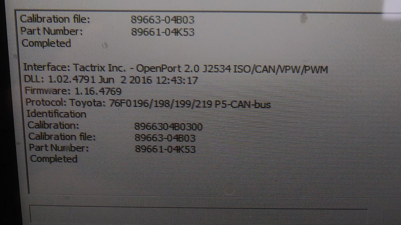

    Guys I'm trying to flash back to 1.03 but having trouble... It keep saying file currupted... I cannot DL new 1.03 file from flash manager because it will only DL 1.04. Ive already submitted a ticket to Matt last week and he had instructed me to DL new PCM flash but still not working. I know I should wait for him on further instruction but with him beeing busy, thought I ask incase someone could help me out. I think my original files is corrupted. Hopefully matt can email me the file since file sharing is no longer allowed, per @OVTune
    I'm getting bad mpg and heavy clunk (more noticeable) on 1.05.
    Note: I know I'm following the steps correctly on my end. Flashing to any 1.05 files is successful. 20190105_102021.jpg 20190105_102108.jpg

    With 1.05 you cannot go back to 1.03 if you received the dealer TSB so that you could run 1.04r
    I am somewhat regretting getting the TSB because 1.03 was awesome

    I'm running o4b03. Therefore I can go back to 1.03.Screenshot_2019-01-06-16-40-09.jpg

    :thumbsup: Therefore looks like it.
