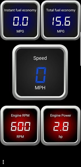

    Is Fusion's $9.99 Toyota add-on worth purchasing? I'd really like to ditch the Engine Power gauge on the screen below and replace it with something that indicates what gear my Auto Transmission is in at any given time, but I can't seem to find anything like that in the options. There appears to be a setting called "Trasmission Actual Gear Status," but that option goes away after pairing with the truck. Is it part of that Toyota add-on?
    (I don't want to hijack this thread with a bunch of ODB sensor talk; so, if anyone knows the solution or has feedback on the add-on purchase, please send me a PM with that info).
    BTW, this is my idle screen with 1.05 93. When the heater is OFF and the engine has warmed up, my rpm's stay between 595-605, which is pretty fantastic. :)
