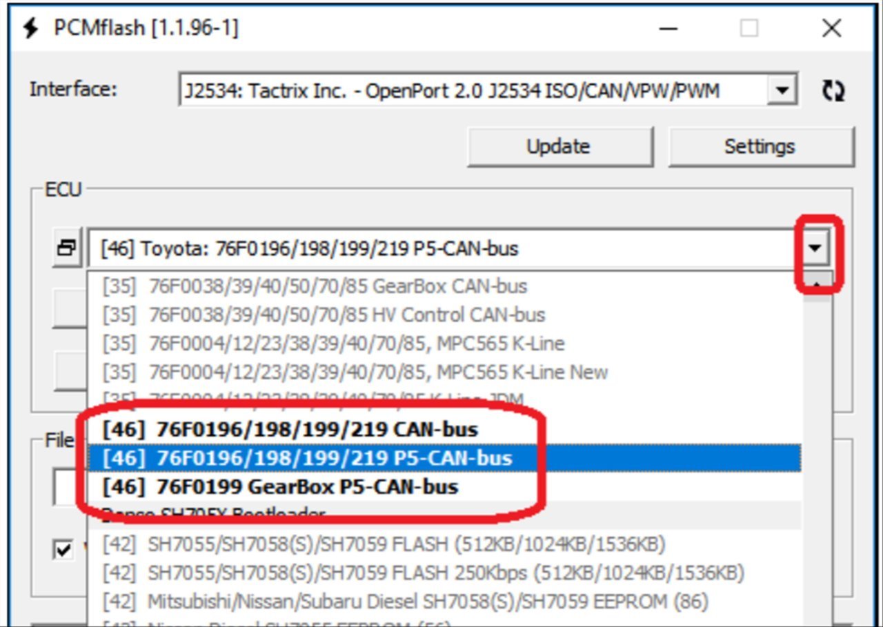

    I'm dongeless, already have my 1.05 tune files, and flashed my truck today using the old flash manager app I have outlined above. I just need the latest version of the flash manager. Still need to ask Mat?

    I flashed the first one and the gear box.....
    Maybe this is why I’m having weird things happen

    v1.05 there's only one file to flash, the one for the ECU. If you've done something else you should probably email Mat to find out how to fix it.
