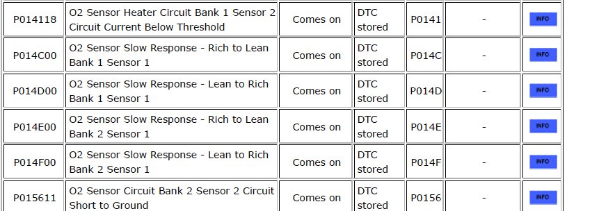

    yeah, looks like the one code is injection related and the other isn't present in the service manual, but seems the P014-range of codes is all related to O2 sensor feedback...

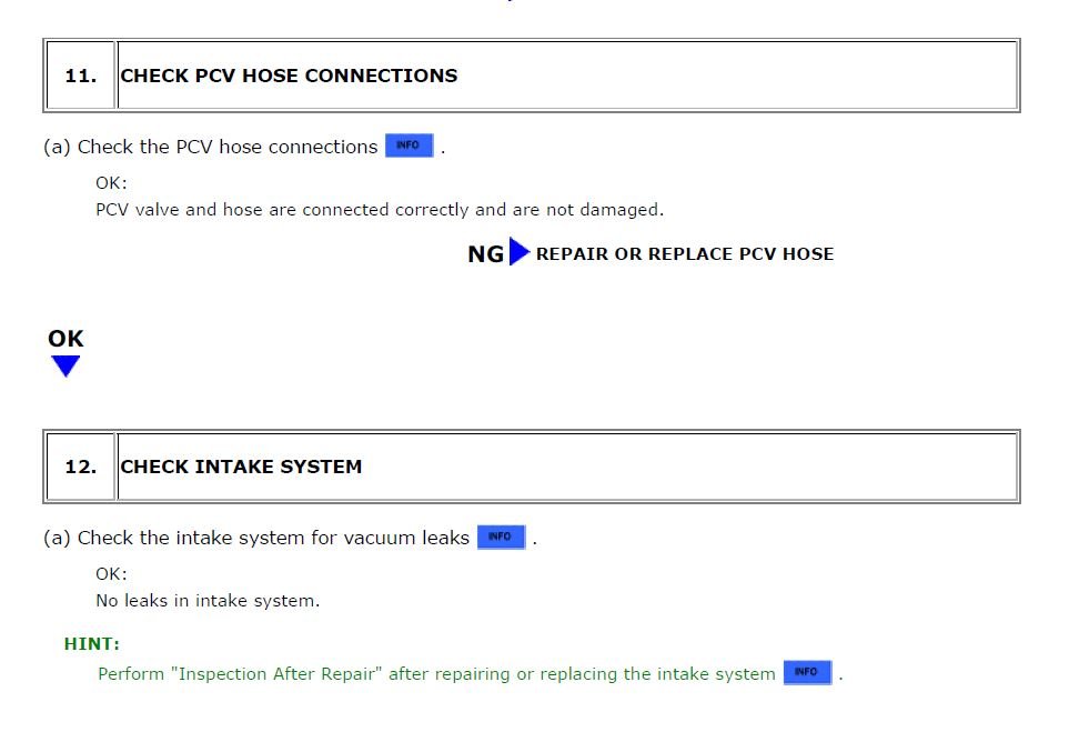

    Well, after reading through the diagnostic procedure for those codes you get to a point where active tests can be done with techstream to see if the system remains lean in real time. If after forcing the use of direct injection and then Port injection, and the system is still lean on both, this is next:
    Keep in mind that one of the first things Mat did long ago was to lean this sucker out. Perhaps that IN ADDITION to your CAI is causing the codes to be set. Just a guess...
