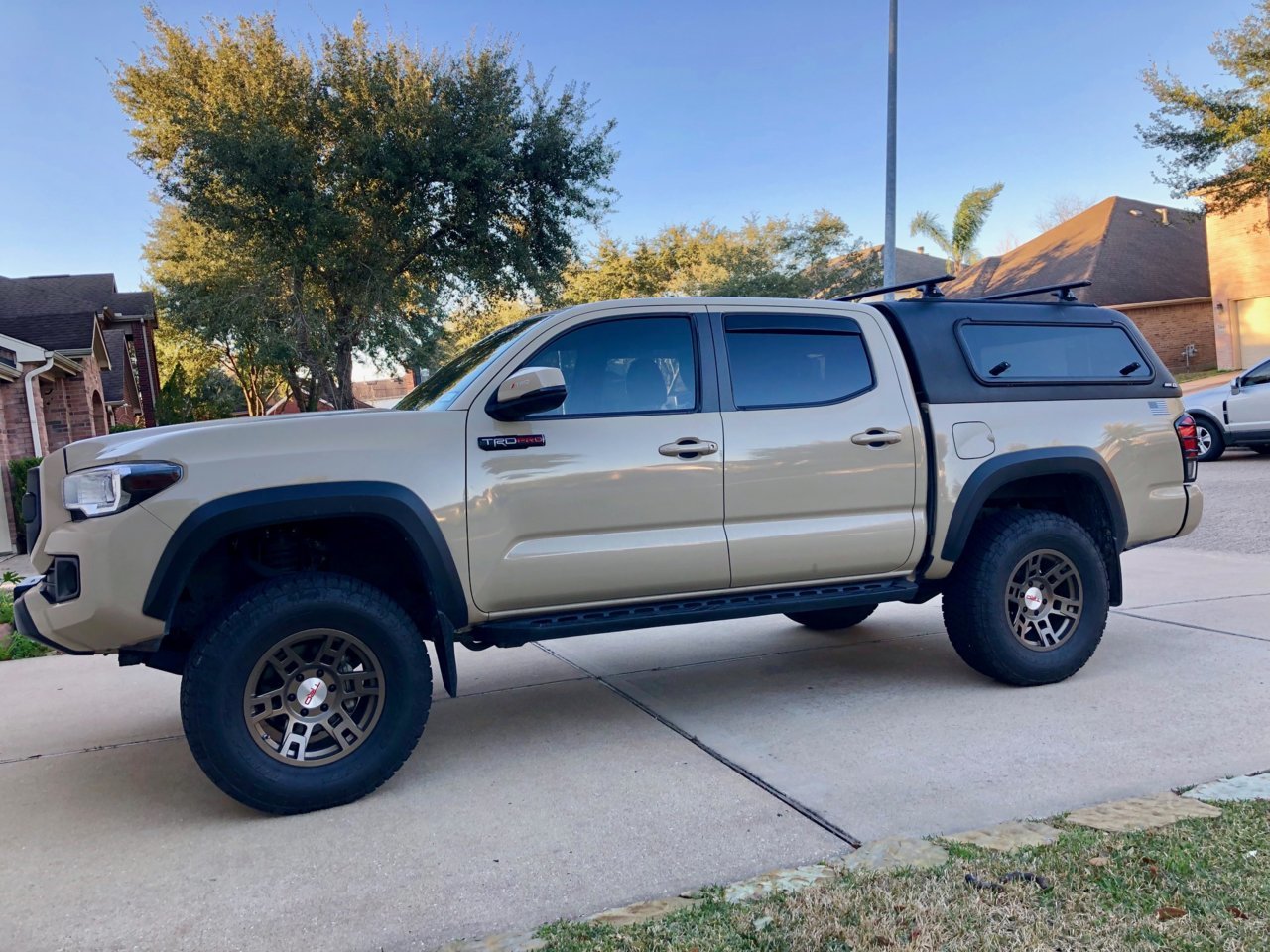

  4. Jan 19, 2019 at 3:05 PM
    SurfratTX
    SurfratTX Well-Known Member
    Mar 9, 2016
    #180710
    1,333
    Lee
    SE Texas
    2017 Tacoma TRD OR Quicksand
    Update...
    2017 TRD OR DBLC, A/T, 285/70r17, 2” Lift, ARE Overland cap painted with Linex.
    TRD Pro exhaust.
    TRD CAI.
    Came from original 1.04 91oct always ran 93oct.
    Now on 1.05 93oct.
    After 420 miles all I can say is sweeeet!
    Gets up and goes like 1.04 91 but way smoother shifting.
    And gained a definite 1 mpg.
    My only hills being fwy overpasses, checked cruise control, same, way better holding gear and shifting is nominal. Awesome!
    I did use ETC mode in fwy hi-speed traffic.....I will call it insane mode....sensitive the way it needs to be, truck gets it on.
    Truck drives the way I would have expected it to, now. Shame on Toyota!!!
    Matt awesome job!
    I am going to try the 1.05 87 tune and run 91 just to see if any better than what I am running. Otherwise back to 93 oct tune.
    Regardless, way satisfied customer!!!
    Matt...again, kicked ass with this tune!
    Mucho gracias!
    Picture of what truck looks like with OVtune 1.05 93 octane.....
    And for all the haters out there, got my MESO TRD Bro badges to replace my not street legal TRD Pro badges.....
    :crapstorm:
