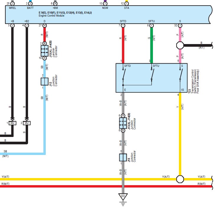

    I really didnt think it would be as easy as swapping the 2 pins, but it looks like it is...
    Just swap pin 1 (red) and pin 3 (green) on connector T23... (i assume much easier than accessing the ECU)...
    (obviously no warranty if this makes your truck explode...)

    Holy crap!! That's great! I'm going to see if I can find some of the connectors and make a jumper to swap.
