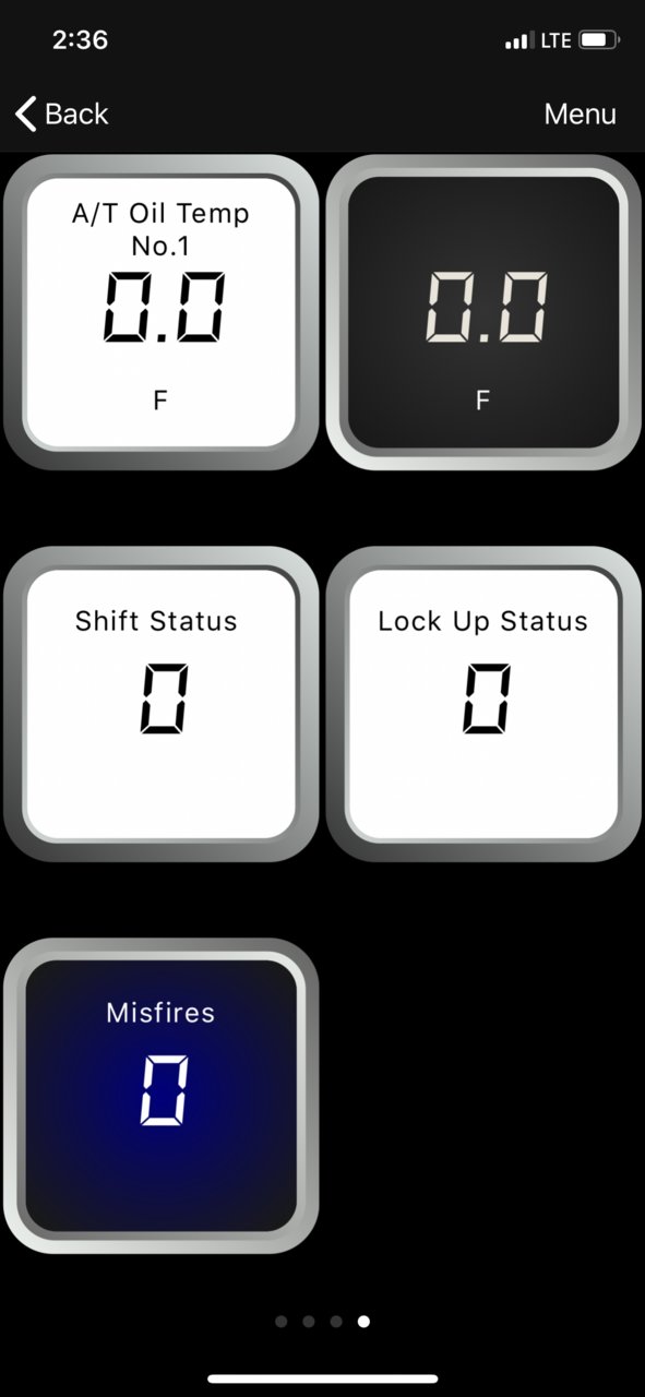

    I used the OBD fusion app this morning and it read 0 almost the whole time. But at one point it read 5 when i was at low rpms going 50 mph on the freeway. Then once I sped up it went back to zero. That dashboard doesn't make sense to me...
  2. Jan 24, 2019 at 9:38 AM
    Vlady
    Vlady Well-Known Member
    Dec 20, 2017
    #238986
    4,434

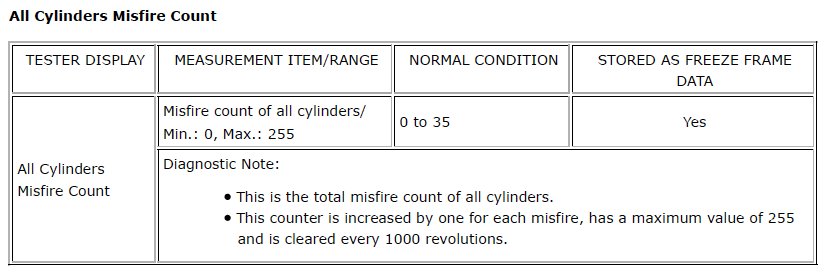

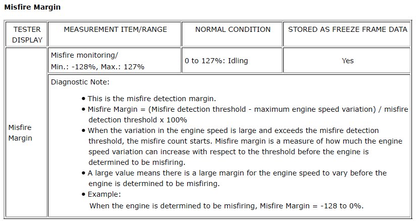

    That's a lot of misfiring (subject of debate, I suppose) when at speed on the freeway IMHO. Per the service manual, the counter resets itself every 1000 revolutions so it isn't a static value that keeps climbing. The mode $06 will show a full tally of all misfires in a drive cycle however.
    Reading this and comparing to the old CPS TSB, it seems to me the CPS is reading engine speed based on the teeth on the rotor - and variations in engine speed as @OVTune stated that are out of expected ranges will trigger a misfire. The CPS replacements were stated to be as a result of excessive anticorrosion coating on the crankshaft rotor, but the "fix" was to replace with a difference CPS that wouldn't be affected by the loss of gap (and static charge) of the slightly enlarged rotor with excessive coating. So it could well be that trucks who had that issue log misfires inaccurately as a result? The tune still makes some of our misfire counts go significantly higher but I'm just trying to assess where a common theme could be in those who have no misfire behavior vs. those who react as unstable when ignition is changed on the tune?
