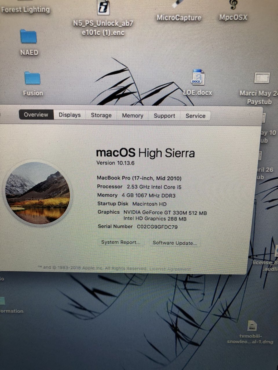

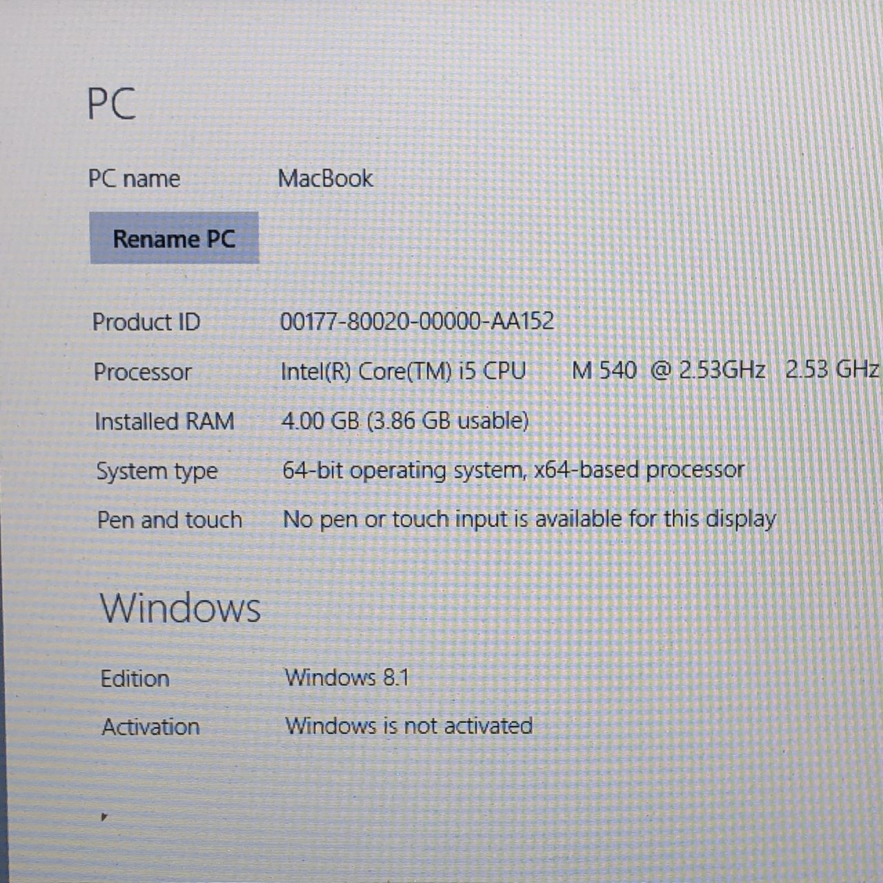

    You’re not correcting me. I’m running High Sierra with Win 8.

    Not sure what your problem is...
    9592AC52-9B6B-411F-8461-C9398950DF51.jpg 78CE0ED1-7F06-489A-97B1-A4DD637E376F.jpg
    BlkTaco47 and Tharris242 like this.
