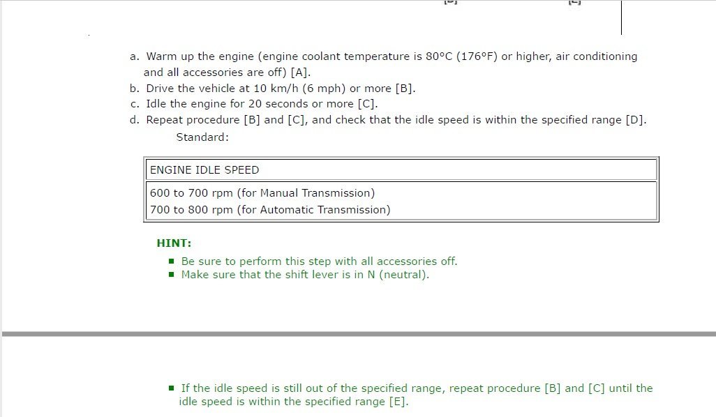

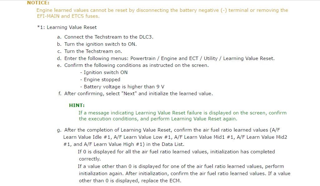

    Is disconnecting the battery supposed to reset learned values?
    If so, the service manual says it doesn't reset values.
    Mr. Nobody, nxcess, Taco16LB and 3 others like this.

    Thanks for posting that. Maybe that's why Mat said to disconnect for 10 minutes, instead of just a few seconds? And it seems my idle is below tolerance @ less than 600 rpm.
  10. Feb 6, 2019 at 5:49 PM
    OVTune
    OVTune [OP] Well-Known Member
    Mar 27, 2017
    #214557
    8,112
    OVTune

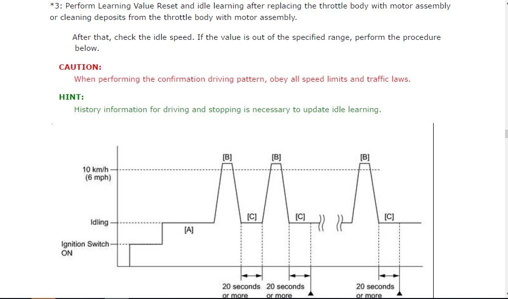

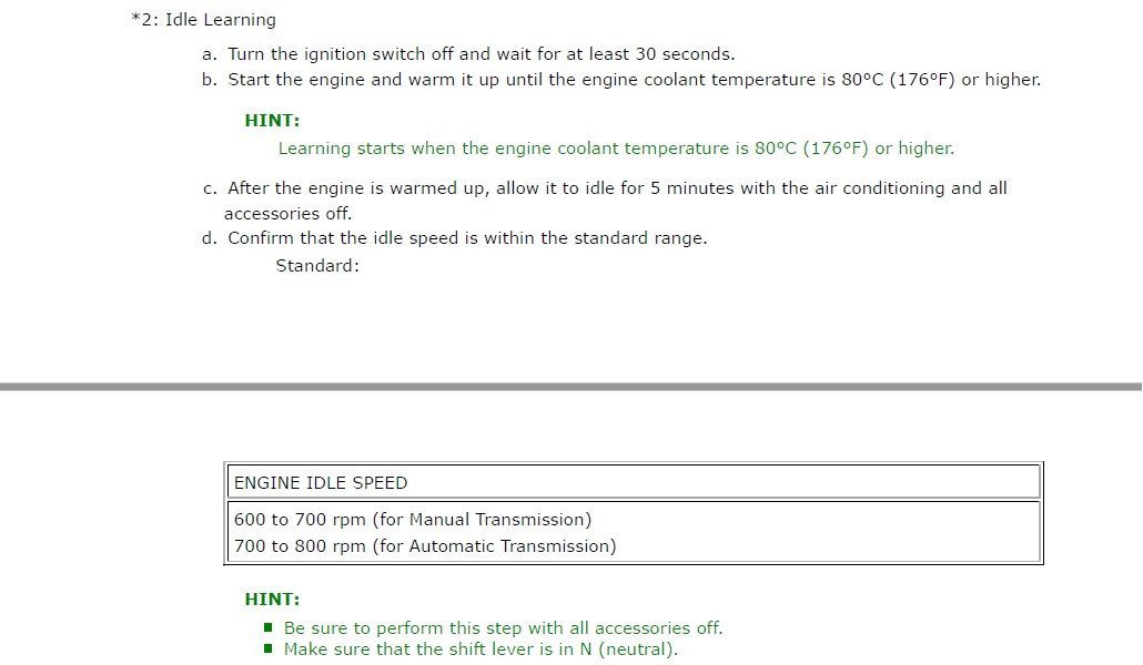

    Service manuals normal idle tolerance is +/- 100 rpm from 550 to 650, a 100 rpm variance in idle is big, along with that odd idle target, that's why our new map corrects it.
    I'll double check through the manual to see what it says, but if you only unplug for a few minutes it won't. Has to be long enough.

    You can tell when the learning values are reset, the truck will drive like dogshit for like 10 miles or so.
    I used the following steps in techstream. ECU - Utility - Learning Values reset
    Transmission - Utility - Clear Memory
    Saw similar behavior with a 30 minute battery disconnect (Trip Meeter reset)
