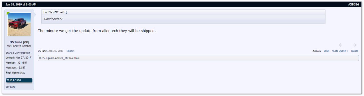

    Sorry I hurt your feelings by answering your question literally, and giving you the same answer Matt did by pointing out his latest mention of the handheld status. I follow this thread for updates; if you think I’ve needed babysat then feel free to search this thread for anything I’ve asked for, which is nothing.

    Mat has said he was waiting on the vendor, what more conversation is there?
