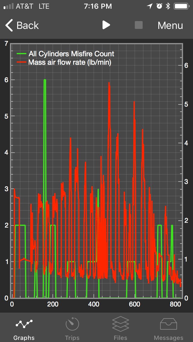

    How can you guys tell when the misfires occur? I’m using Fusion, but am still still trying to make sense of the graph.
    Taco16LB likes this.

    On fusion, if you have your GPS enabled on your phone, you can pull up a map and it will show you on the map where they happen.

    I haven't tried to log the misfires. I just use the Monitor/Mode $06 and scroll to where the count is displayed. Then I glance down at it periodically as I drive.

    If you have the Toyota pack, go under that to engine. There's one that says "all cylinder misfire count," that will show you all cylinders. If you scroll down farther to misfire, you will see the ones for each cylinder, and a few other options.
    Edit: just realized you said torque, not fusion.....my bad.

    My all cyclinders misfire count pid seems to always reads 0. My $06 monitor tells a different story.

    It only shows it for about 1000 RPM, then resets back to 0.

    The $06 shows the running total for that trip, until you shut off the engine. The All Cyclinders Misfire Count pid resets itself every few seconds to every minute (depending on RPM) as @ihatemytruck indicated.
