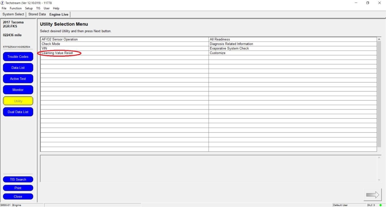

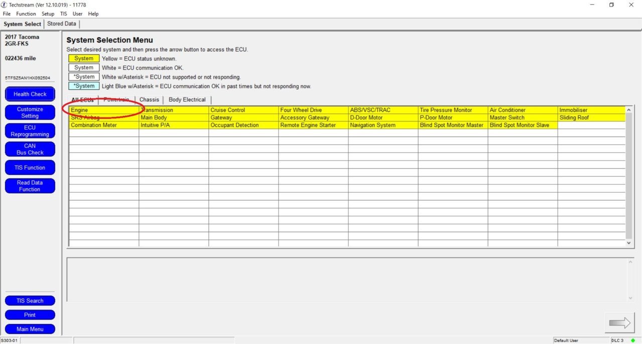

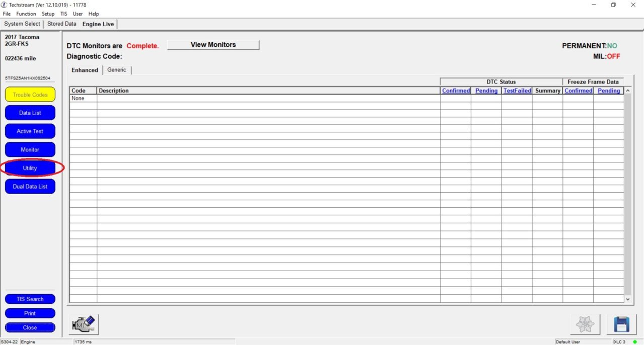

    I was going to say it looked like he had toy flash open and not Techstreamo_O

    I just did this. Too easy thanks to your post. :thumbsup:
    ETA: And after the 10 minute idle, rpms in tolerance about 700 rpm, up from a hair over 500.

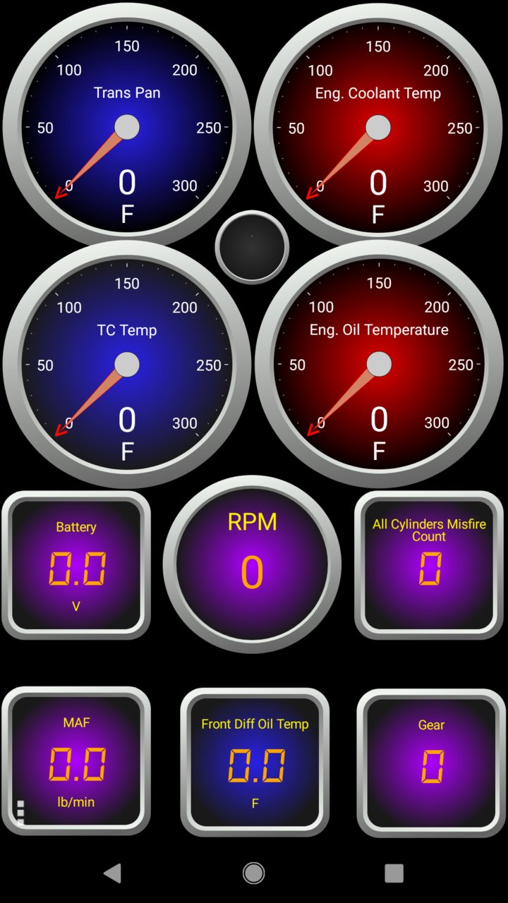

    Coolant temp, engine oil temp, trans pan and TC temp, TC lock/unlock, RPM, shift status, battery voltage, maf, front differential, O2 sensors, knock stuff, fuel flow, etc.

    Have a screen shot?
    Why monitor the TC lock

    I monitor TC lock just out of curiosity.
