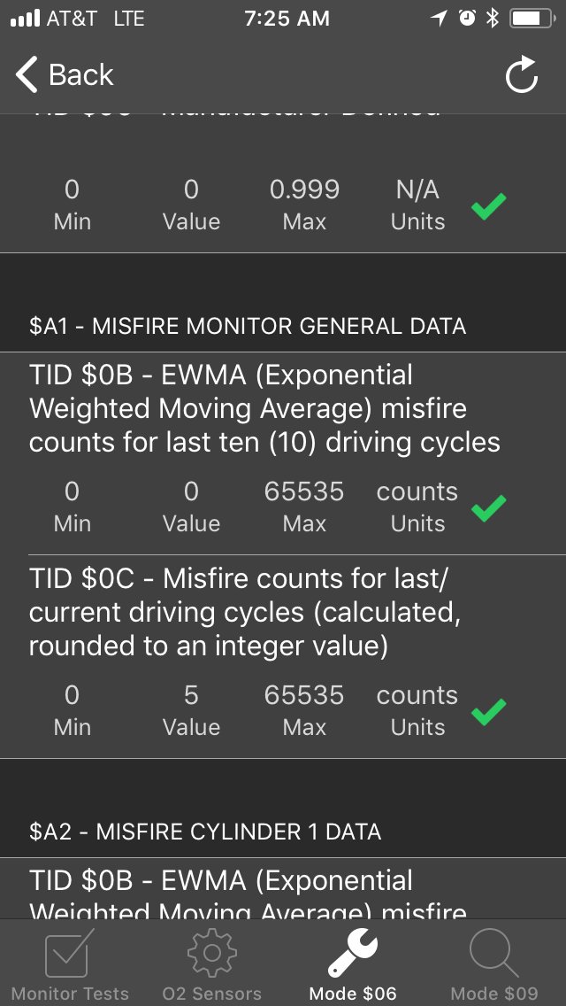

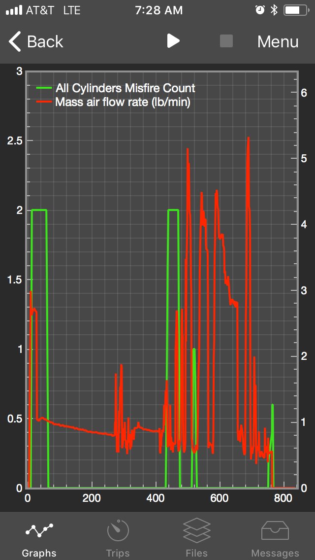

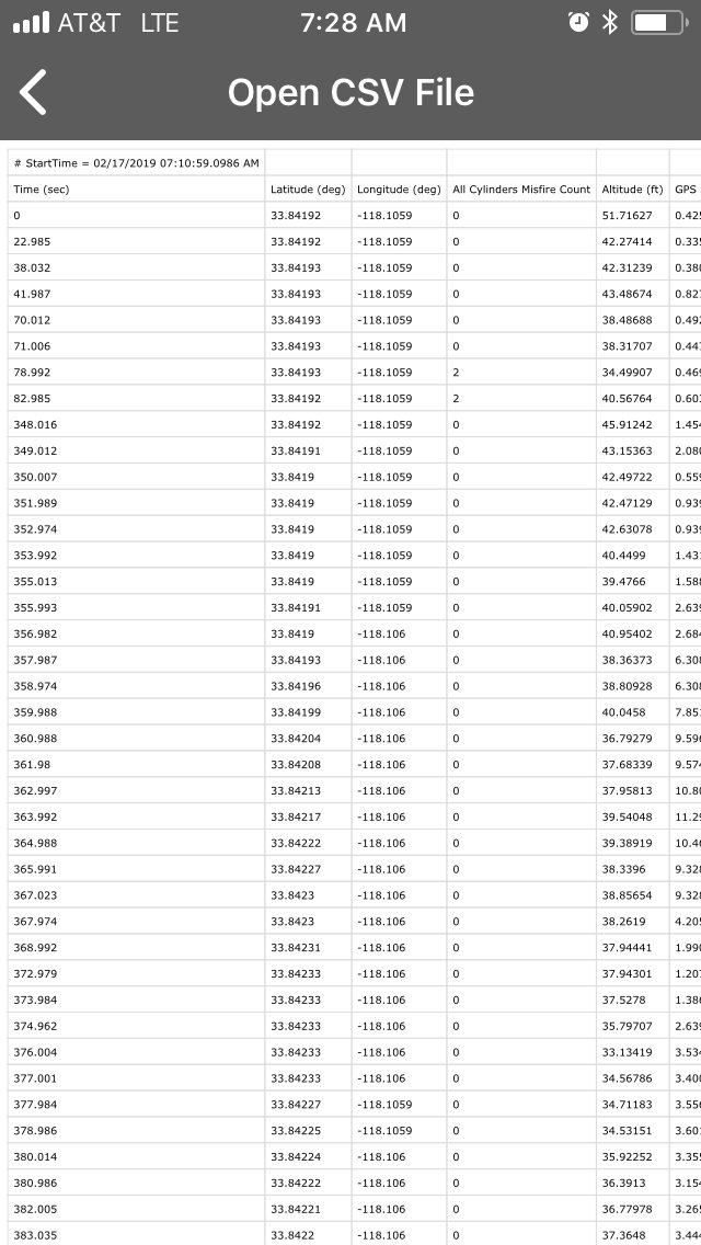

    Question for you Fusion Savvy users: What number do you use to reference the number of misfires on a given drive cycle?
    Details: Im running Fusion through Kiwi.
    PID: The “all cylinders misfire” pid always reads 0 (when I’m watching it). I understand that it clears after a short time, but I’ve never seen it say anything other than 0.
    Logging: The log graph shows activity, but I’m not sure how to read it (see image). @bshammer0 mentioned changing the axis to time, but I couldn’t figure out how to do that.
    Mode $06: This monitor has two items that seem relavant: TID $0B and TID $0C.
    I figured $0B applies a value of 1 for every 10 misfires for the last 10 drive cycles, but that’s not the case. I’ll log 10+ misfires on one cycle and then the very next cycle sometimes shows 0.
    Previously, I was relying on $0C for the misfire count on the last drive cycle, but then I found the CSV file in the log folder. I figured if I add all noted misfires in the CSV file, I should get the same number as the $0C, but they are different numbers. The sum of the numbers in the misfire colum of the CSV file in this case is over 80. I’m oretty sure I’m not having 80 misfires... 0E25E285-EB50-4F23-8786-C16452F4CBDD.jpgAC5E37CE-5FFB-427C-B1E5-B212775472D7.jpg E8021D7C-0184-4849-85A8-AA4220203404.jpg

    No, you dont have 80, you need to count misfire for each cylinder to match it up to mode $06 $0C.
    Add misfire PID for each cylinders
