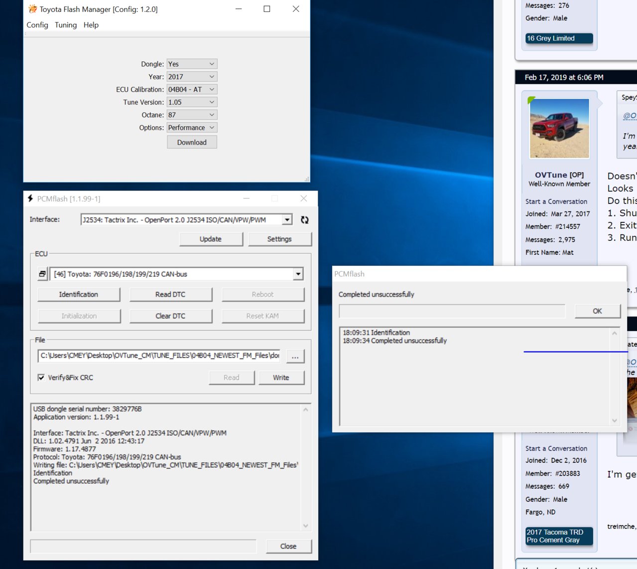

    Doesn't matter. FM is by calibration year not model year.
    Looks like pcmflash is not seeing your truck, that's the issue.
    Do this;
    1. Shut truck off
    2. Exit all software
    3. Run software connect to truck, flash

    I'm getting this same error. X64 version.

    it's doing a 2 second flash then successful, doesn't seem right

    Still only getting 2 second flash

    Worth a test : shut truck off, turn truck on. Click "CLEAR DTC" then flash.
    Ecu may be stuck waiting for a response key from trying so many times.
    Or start the truck then shut off then try.

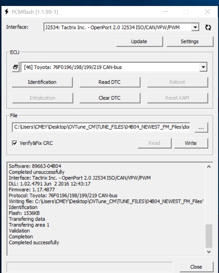

    Funny thing is, I clicked the dropdown and selected P5-Can instead of CAN-bus, flashed, failed.
    Then went back and selected CAN-bus, flashed, success...but it took like 40 seconds this time. Thoughts?

    Truck starts fine?
    Shouldn't be an issue there isn't really a difference between the two except the CAN is the barebone version of P5CAN firmware

    yah, truck started. Now have battery disconnected. Then going to do 10 minute idle. What seemed weird was how fast it flashed (under a minute)

    Mine did the same. And it runs better than it ever has now. 93 base tune.
