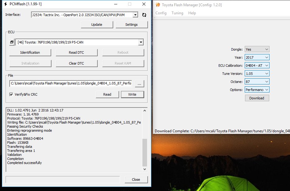

    Thanks Mat for sticking with me and helping me through it. Took a drive and the 87 Performance tune is quite nice with great tip-in. I can imagine the higher octane tunes are gnarly.
    You are the man.

    yep all good now

    For all you guys running the higher octanes. I flashed the 87 performance tune and it is night and day different from the previous 1.05. The response is amazing, my truck is back to feeling 1000lbs lighter and the tip-in is awesome...the higher rpms is a bit alarming in first.
    I'll bet those higher octanes feel even better with even more power. 91 may come in the future, but for now im going to run this 87 tune until summer.
    Nice job @OVTune. Thank you for being so patient
