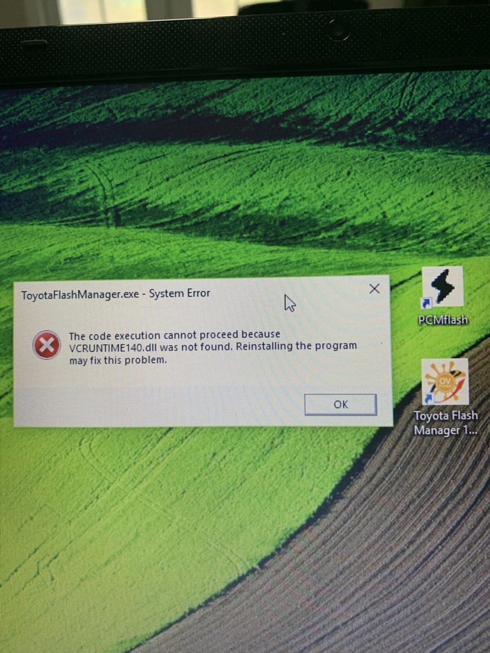

    Post a pic of the error, or tell us exactly what error and that will help a ton.

    …here you go

    So FM is open and running, but you can’t download files?

    From Flash manager ..error downloading file ...iv'e purged ,installed ,and updated per instructions

    Are you selecting to correct ID? My truck is 2016, but 04B04 so I had to pull tunes from the 2017 04B04
    If it is still throwing an error after you confirm the above it is likely the antivirus software

    On the 1.00, and 1.02 x64 I get the same error, which is that the PC can’t run the software.
    On 1.02, x86 I get the attached image error. Qt5widgets.dll error.
    I’m running a RCA Cambio on Windows 10 (32 bit operating system, x64 based processor). Windows is up to date.
    Strange that the x86 seems to get me closer than the x64 FM. I have tried the update through Microsoft Visual Studio C++. The x86 update runs succesfully, while I get an usupported error for x64.
