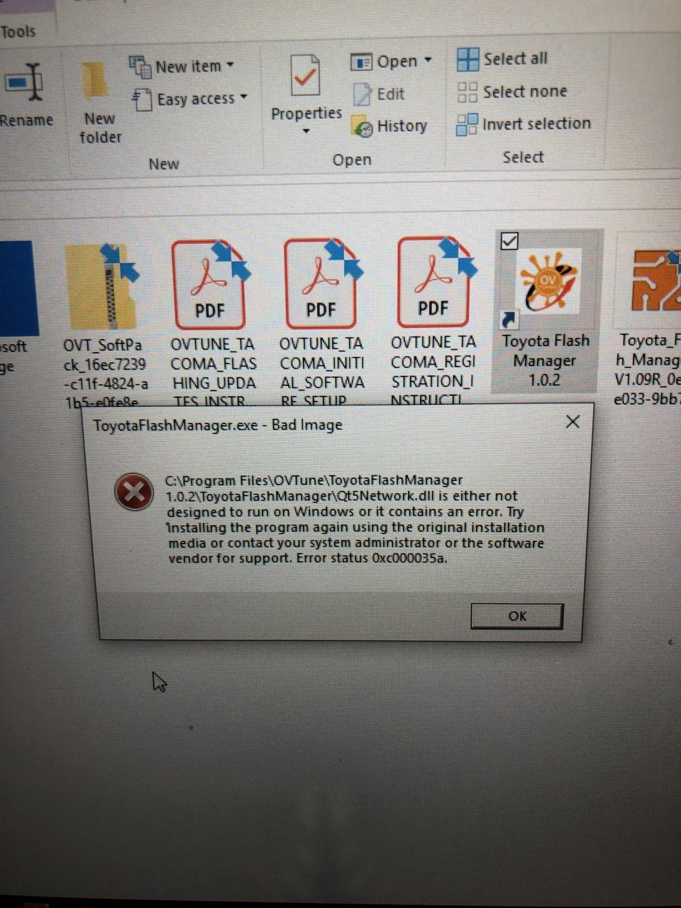

    Got through step1 of installing software but when zi got to step 2 (run flash manager) keeps sending me right back to step one?

    32 bit OS so you want the 86. You wanna do the C++ updates from Microsoft
    Processor range doesn’t matter if the OS is running on a 32

    Downloaded FM. Got .dll errors. Downloaded c++ redistributable x64 and it worked now waiting for 04A61 performance tune. Also, did anyone have luck flashing with usb 3.0 or am i gonna have to find an adapter?

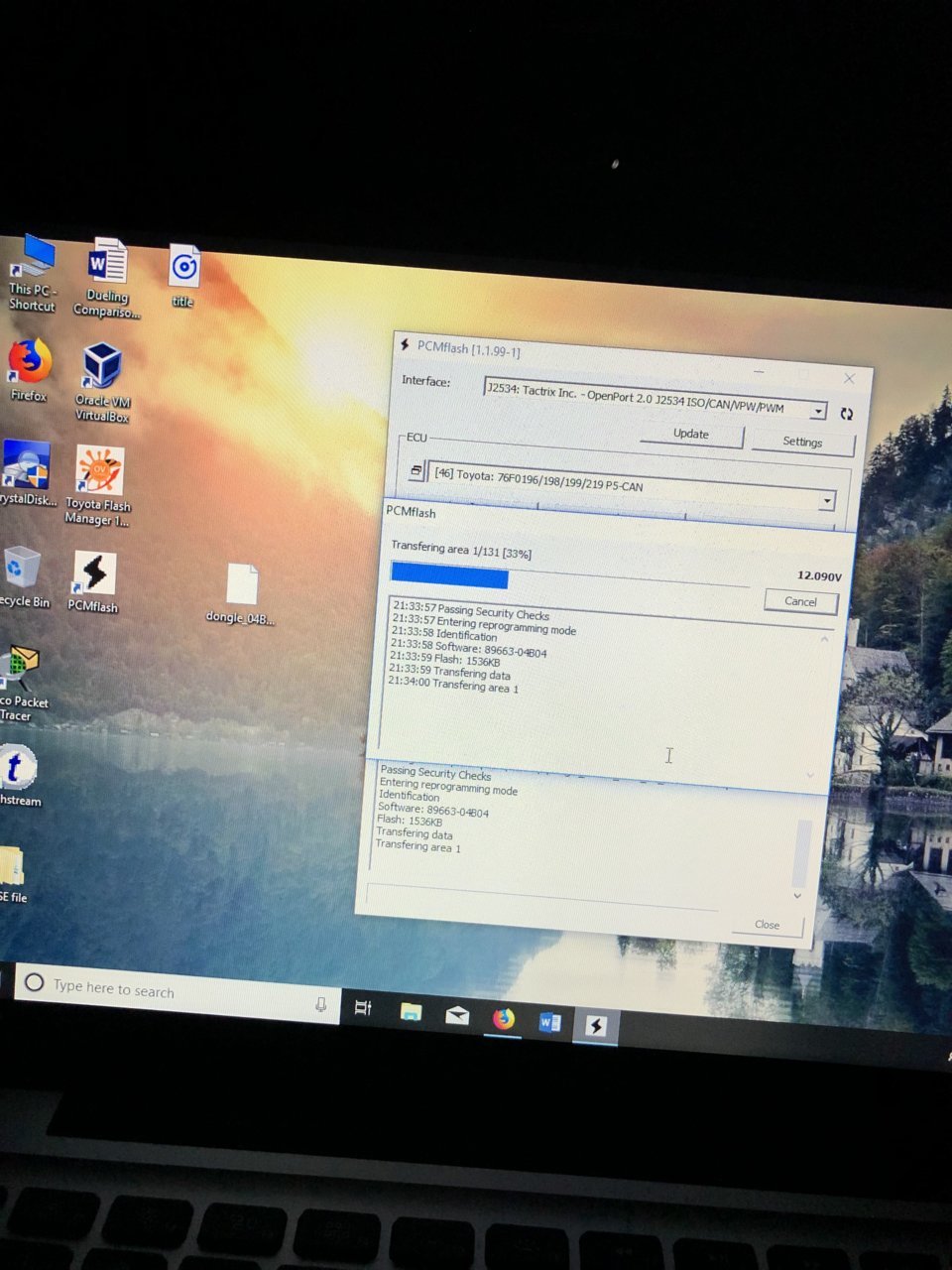

    Rus$ likes this.
