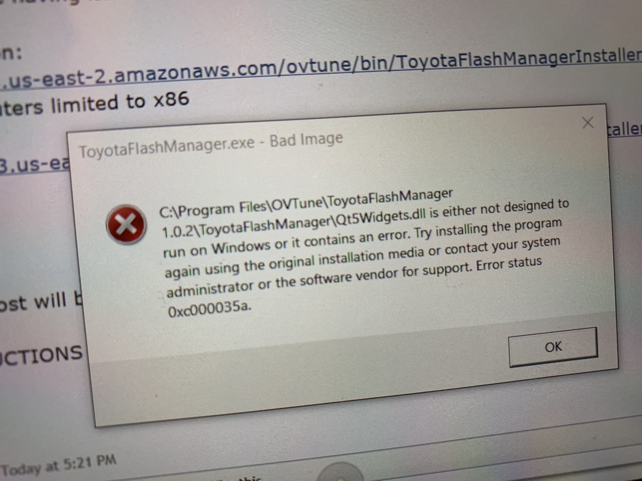

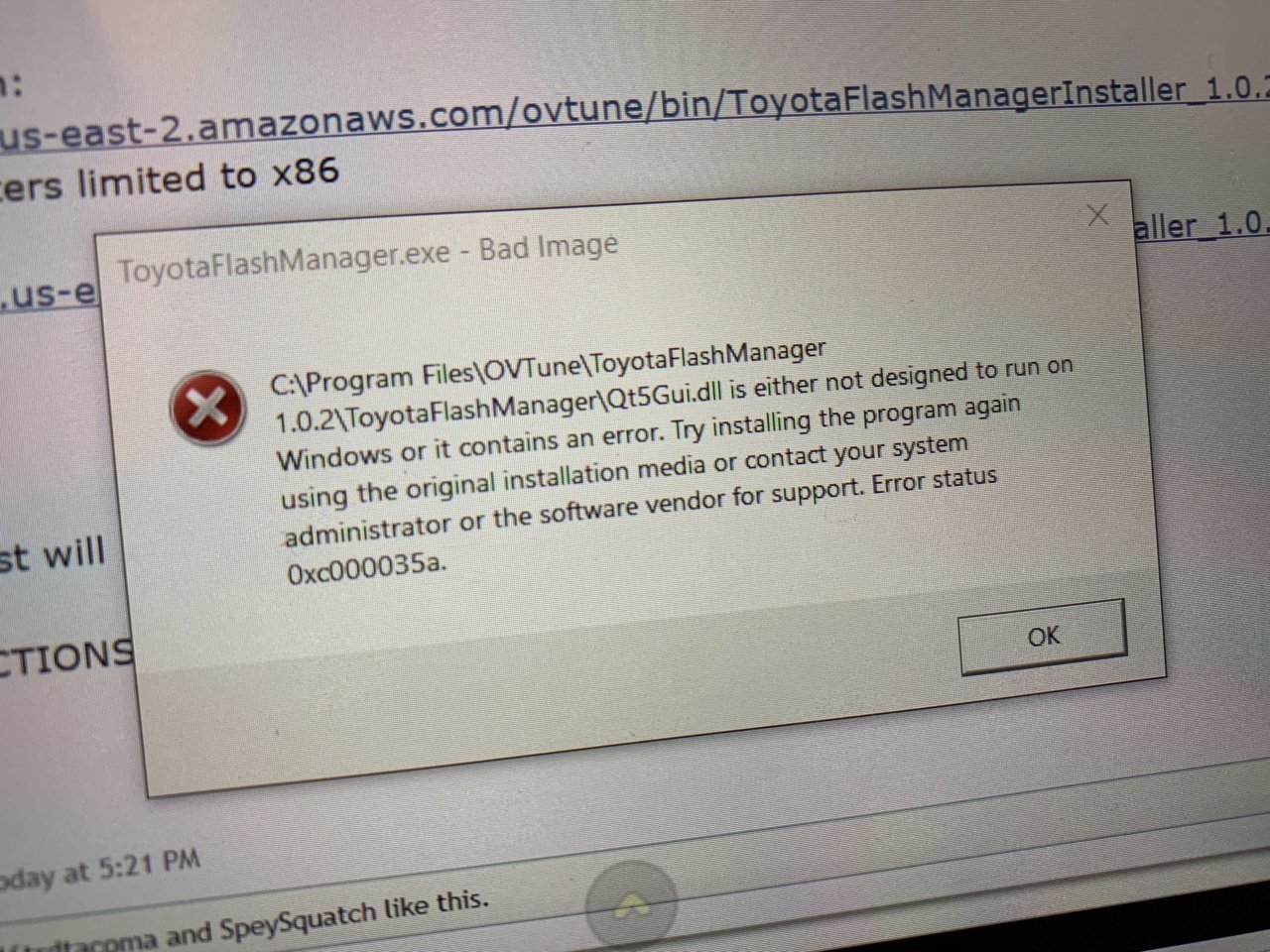

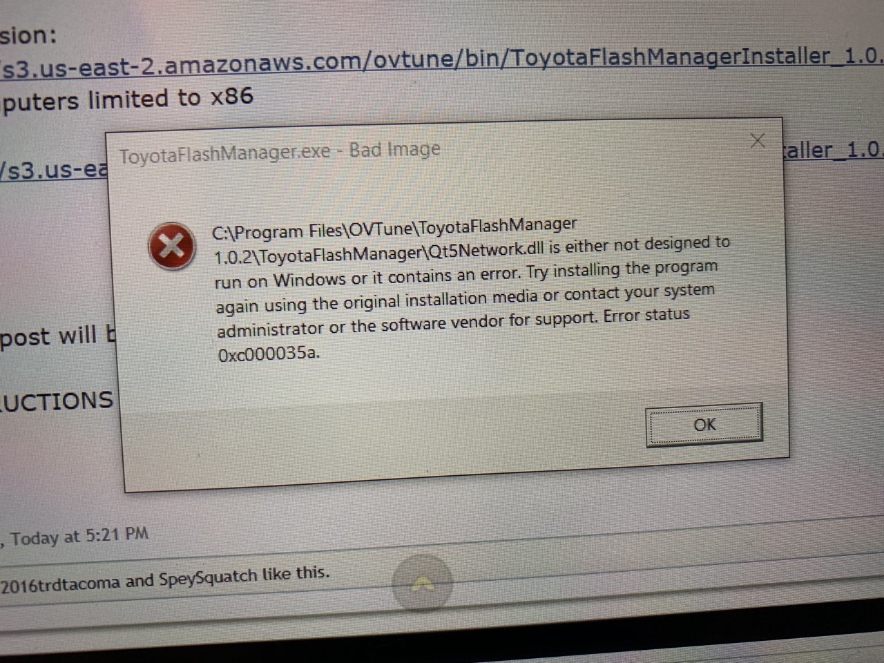

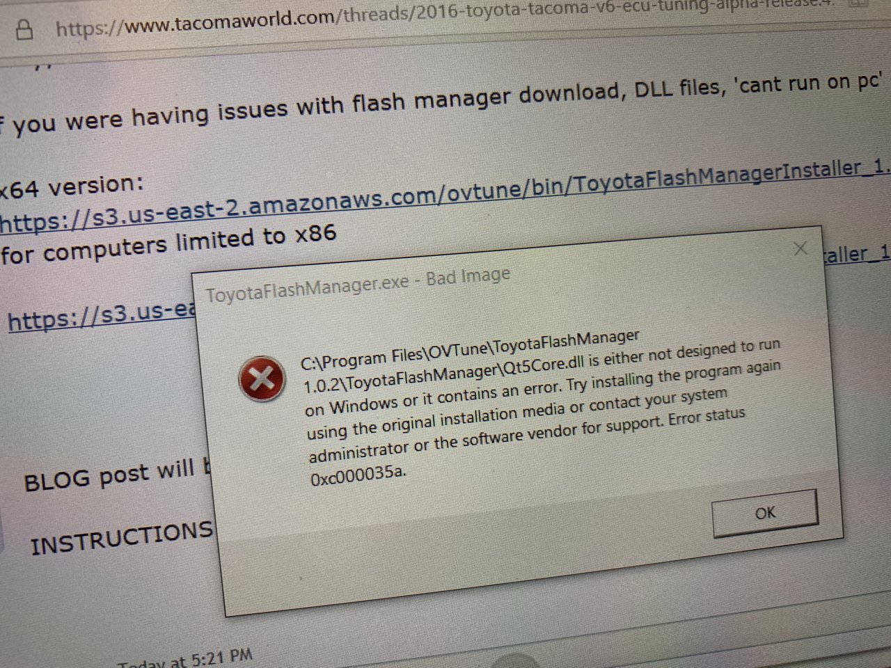

    Continue to get the following even with the new 1.02 FM links Matt posted when I try to run FM. Installed the last MS Visual C as well.
    Running Windows 10 32bit x86

    It looks like the x86 (32bit) version was inadvertently bundled with the x64 dll's. Hopefully we'll get a repackaged installer today.
    perkj[QUOTED] likes this.

    Okay so x86 will be repacked and fixed. few little bugs, but so far so good.

    I don't see anything available yet for 2016/AT/04b03
    had the same c++Redistributable errors as many have, the
    quickest way around these ( no reboot needed ) is to remove
    any you have from updates in your CP and then reinstall the
    latest ver. found here - https://www.microsoft.com/en-eg/download/details.aspx?id=48145

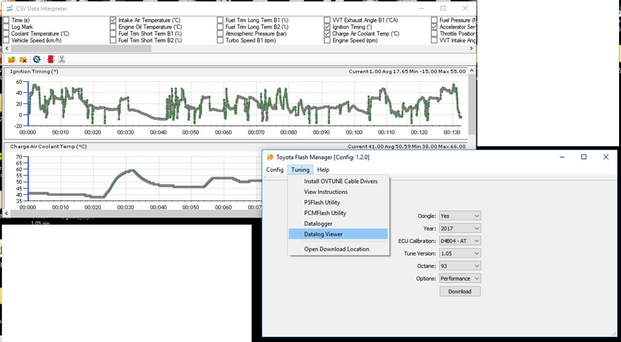

    Playing with FM last night and did this. It auto saved it in the same folder as the tunes folder. Nice!

    The datalogger? :)
    Also I hope you guys like the performance versions. took a lot of work to get to this point. If anyone has any issues please let me know by submitting a ticket to zendesk.

    OVTune
    nope! Glad it was working!
    Also FYI if you want an easier way to view your logs use the log viewer tool in flash manager :)
