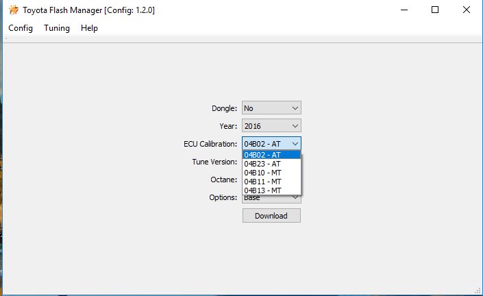

    I just downloaded the new FM and of the selection within the drop down menu, there were no 04B03 choices at all - neither base nor performance...

    Click on 2017 and they should pop up
    SurfratTX and Burmapeak like this.

    I think you may need to look under 2017 but you should probably check with zendesk to be sure.

    The year of the truck doesn't matter, just the ECU ID. It should be under 2017.
