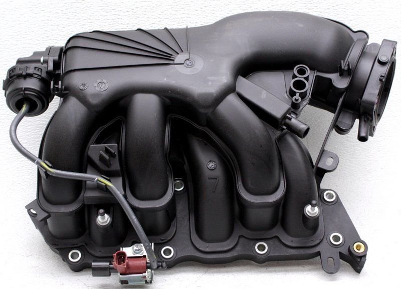

    This weekend we will be testing out >
    New, Modified intake manifold (Short plenum version for FKS engine)
    Tundra Throttle
    ACIS delete
    All in a Modified induction package.
    kritz, jholc21, Rus$ and 12 others like this.

    #231055
    31,267
    tony
    Lynnwood, WA
    Very interesting.
    What is the benefit of the Tundra throttle?

  8. Feb 26, 2019 at 10:46 AM
    OVTune
    OVTune [OP] Well-Known Member
    Mar 27, 2017
    #214557
    8,112
    OVTune
    Hopefully this entire setup will create more airflow being drawn into the engine.
    We are retaining stock intake box during testing and comparing Flow graphs. We want more flow everywhere, and are testing this setup out to see how it does.
    Using a modified Sienna intake manifold without ACIS, larger Throttlebody, etc
    (also this makes routing intercooler piping much easier...)
    taco 16, tazmoto1526, hbaade and 6 others like this.
