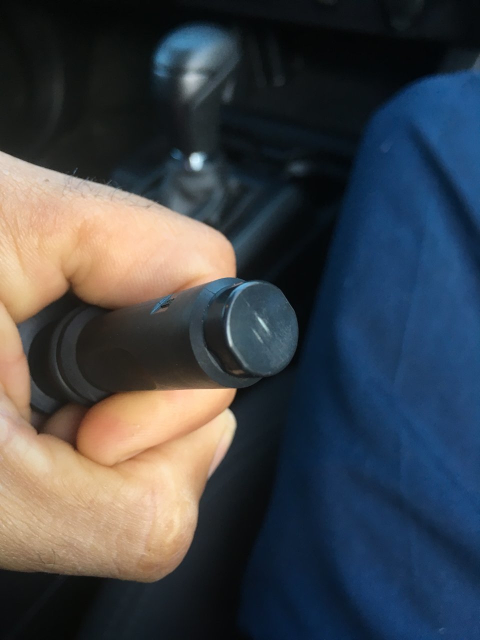

    I cleared learned values from the engine and transmission (the transmission was unnecessary), so I can’t say weather the differences I felt were from the sensor or the clearing.
    The only thing that stood out to me was the scratches on the sensor. I’ll try to get some photos today.

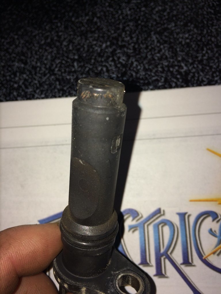

    Here's what mine looked like (scratches on the end and rusty metal filings lol):

    Holy hell that's insane.

    What is that exactly? o.0

    CPS

    The crankshaft position sensor. There’s a recall for some trucks.
    Many who are not on the recall list that have replaced them on their own have experienced positive results. @bshammer0 probably stands out the most. My truck had bad misfires. 20+ was not uncommon. I had 38 the other day and it was less than a 5 mile drive. Last night... I had 1!! (after replacing)
    Here’s my old sensor. There are noticeable scratches on the face of it.

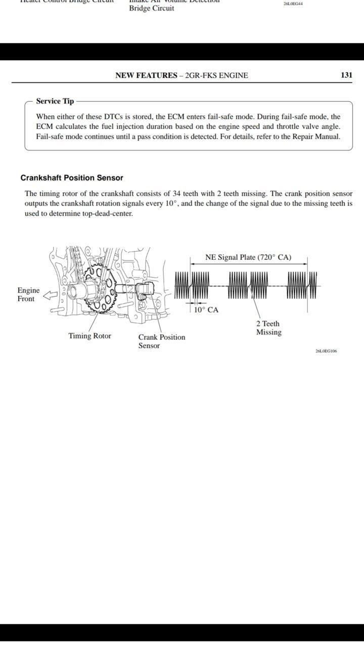

    Its actually a reductor/reluctor? (not sure what its called) ring on the front of the crank behind the crank pulley.

    Ah, I see. Well. I found a picture of it. Looks like you'd need to take the timing cover off to check it out. I'd still look at the new sensor for marks if it was me.

    I'm considering swapping my CPS too or at least checking my current one. Those scratches look to contact marks which is not right.

    Agreed on the source of the scratches.
    Toyota, as far as the recall goes, claims that the sensors are failing because of grease being flung onto the sensor, which creates a reduction in the “gap” between the sensor face and the rotor. I’m calling BS.... clearly in my case, there was no gap with or without excess grease.
    From Toyota:
    The V6 engine crankshaft timing rotor in the involved vehicles may have been produced with excessive anti-corrosion coating. This could cause the crankshaft position sensor to malfunction. If this occurs, the vehicle may display a Malfunction Indicator Light (MIL), run roughly, misfire, or in some instances, stall. A stalling condition while driving at higher speeds may increase the risk of a crash
