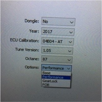

    My experience with the Gear Lock 87 tune.
    Ok, the Gear Lock tune works as advertised. It will hold each gear, but the TC will unlock in each gear to get you the extra RPMs to get you moving as you press the throttle.
    Cruise Control is annoying enough on the baseline 87 tune. This very was apparent on my way home yesterday using GL and cruise control, in a headwind, on level road.
    With Gear Lock enabled and in 6th, the TC would cycle unlock and lock about every 3-5 seconds to keep me at 60MPH. Very annoying.
    The baseline 87 tune, under similar conditions, would just drop into 5th and stay put.
    I thought the GL tune would alleviate or end the annoying cruise control 'porpoising' on the highway. Not faulting the tune in anyway, just my observations.
    Going back to 87 baseline ASAP.

    From OVTune

    GearLock is not functional during cruise control
