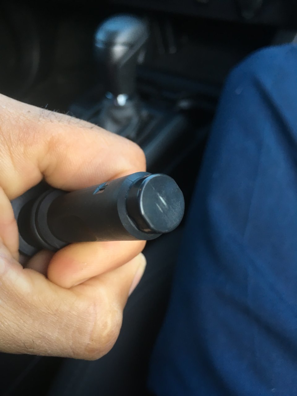

    After logging more drive cycles, looks like my misfire count is back to usual. I’m going to give it a few hundred miles to try to settle in because I cleared learned values after replacemt. Also, when I pulled the old one out, I noticed scratches on the face of the sensor. Seems like the rotor is scraping it as it passes by.
    So, my next step is going to be to pull the new sensor out after some miles to check for similar scratches

    What sensor is that?

    Crank position. The one there’s a TSB for

    Crankshaft position sensor (CKP)
