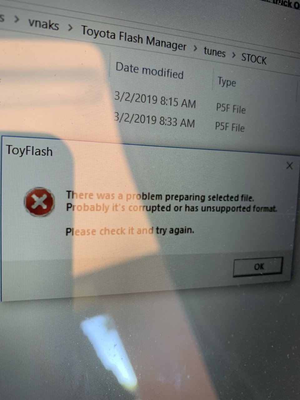

    I’m getting this error message. Anyone know what I am doing wrong? I ran the p5flash software, clicked flash it, selected my file and then this pops up. Please advise.

    If you got the -18 tsb you should be on 04b04 which will be in the '17 year - use that drop down.

    Send a ticket via zendesk.

    it's in the first post

    I didn't get that warning.
