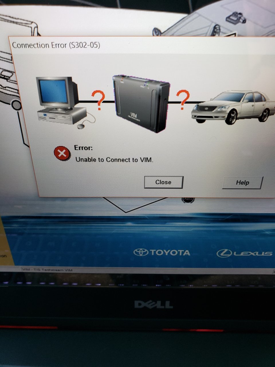

    go2cnavy
    go2cnavy Well-Known Member
    Sep 25, 2016
    #198172
    1,236
    ‘17 OR DCLB. VF Tuned, 5.29s, Dobinson’s MRR
    OVTuned w/ 5.29s 2” lift on Dobinson’s MRR paired with ICON RXT leaf packs. SCS RAY 10s Toyo Open Country AT III 285/70R17
    Haven’t got it yet. I’ll post a review once I use it.
    Onvian 3 Port USB Hub High Speed Splitter Plug and Play Bus Powered https://www.amazon.com/dp/B071JTSMVQ/ref=cm_sw_r_cp_api_i_OVdFCb7K8M9XV
  3. Mar 3, 2019 at 1:31 PM
    go2cnavy
    Sep 25, 2016
    #198172
    1,236
  4. Mar 3, 2019 at 1:31 PM
    Deucer01
    Deucer01 Well-Known Member
    Jan 9, 2017
    #206999
    1,277
    North Georgia
    2023 Tacoma ORDCSB 4x4, 2024 4runner TRD ORP
    Sorry stepped out to clean the pool but I was going to suggest that too. :D
  5. Mar 3, 2019 at 1:36 PM
    Tac0Tic0
    Tac0Tic0 новий член
    Sep 26, 2018
    #267519
    1,098
    SLC, Utah
    17 TRDOR QS
    OVTune Volk TE37XT 17x8.5 295/70r17 G003 Yukon 5.29 differential gears Cab Mount Relocate Icon Coilovers Icon AAL Uptop Overland Bed Rack Maxtrax Baja Designs Squadron Pro Ditch Lamps Rough Country Speedometer Calibrator
    Blister
  6. Mar 3, 2019 at 1:42 PM
    prodemann
    prodemann Well-Known Member
    Jan 26, 2019
    #280779
    76
    Phil
    Carver, MN
    2017 TRD Off Road AT DCSB Silver Sky
    TRD Pro grill, OVTune
    Sick pool brag bro
    Tharris242 likes this.
  7. Mar 3, 2019 at 1:48 PM
    lapoltba
    lapoltba Full Bridge Rectifier
    Aug 28, 2014
    #137089
    3,344
    CT - 06076
    '17 Sport, ACLB, V6,MT, 04B14 OV-Tuned
  8. Mar 3, 2019 at 1:57 PM
    _Bone_
    _Bone_ Well-Known Member
    Sep 4, 2017
    #229062
    47
    Beaverton, OR
    2017 quicksand DCSB TRD Off Road
    04b02 original dongle user here. Didn’t plan on going 04b04 but it seems the way to go now. Haven’t had any trouble flashing ever....but I seem to be having trouble with techstream.
    Followed instructions to install 12.20.024
    -downloaded and extracted the files from the link provided on the obdii365 site
    -copied files to a new folder
    -ran setup application from new folder, entered “name” and “company name” and installed. All seems well so far.
    -copied MainMenu application from the new folder, went to Techstream properties and deleted the MainMenu.exe that was there and replaced with MainMenu.exe from folder.
    -ran the MCVI driver install
    -*this is where I seem to deviate from what’s supposed to happen*
    Run Techstream from desktop, it brings up “techstream configuration”....asks for “area selection”....I select North America and click next. Then it asks for dealer name, dealer code and dealer phone.
    Per instructions it seems I should get something else when launching Techstream.....not the configuration asking for dealer info.
    Any thoughts on what I missed?
  9. Mar 3, 2019 at 1:58 PM
    lapoltba
    Aug 28, 2014
    #137089
    3,344
    CT - 06076
    Nope, that is correct. Enter garbage information and click "next" or "ok". A window should pop up asking for a key. Use the one in the .txt file that was included with your download. Enter it, click okay and restart techstream.
    Inferno__Taco and Tac0Tic0 like this.
  10. Mar 3, 2019 at 1:59 PM
    OriginalMan
    OriginalMan Well-Known Member
    Apr 28, 2018
    #251976
    1,276
    Oahu 808
    2017 TRD OR 4x4
    Bilstein 5100/888; 5160/AAL; SCS Ray10 Limited Gold; 285/70 Cooper STT PRO; AVS; OVTuned; Prinsu Cabrac; RCI Bedrack; TC Bed Stiffner
    You dont need mvci if you have tactrix. Just install FM and you're ready to rock and roll.
    Inferno__Taco and Shellshock like this.
  11. Mar 3, 2019 at 2:00 PM
    Totall4285
    Totall4285 Well-Known Member
    Mar 29, 2017
    #214810
    414
    Palm Harbor, Fl.
    2017 Tacoma TRD Sport
    How do you clear dtc with TS
  12. Mar 3, 2019 at 2:02 PM
    Deucer01
    Jan 9, 2017
    #206999
    1,277
    North Georgia
    And you don't need to install the MCVI driver. Your using your Tactrix (OVtune) adapter and the driver is already installed.
    honey likes this.
  13. Mar 3, 2019 at 2:03 PM
    Deucer01
    Jan 9, 2017
    #206999
    1,277
    North Georgia
    Transmission/utilities/clear learning. I recommend clearing both ECT and ECU.
    Totall4285[QUOTED] likes this.
  14. Mar 3, 2019 at 2:05 PM
    Deucer01
    Jan 9, 2017
    #206999
    1,277
    North Georgia
    South Florida problems. :D
    JMW and prodemann[QUOTED] like this.
  15. Mar 3, 2019 at 2:08 PM
    Oscar I
    Oscar I No longer a toyota driver
    Dec 23, 2018
    #276746
    683
    So switched over to 87 base today just to see how I like the improved 1.05 and it's pretty decent. I might leave it there for awhile and wait on the milder tip in performance 87 mat was testing Friday. The tip in was something I did get used to but didnt really love it
  16. Mar 3, 2019 at 2:08 PM
    _Bone_
    Sep 4, 2017
    #229062
    47
    Beaverton, OR
    Perfect thanks for the help. Looks good to go :)
    Deucer01[QUOTED] likes this.
  17. Mar 3, 2019 at 2:13 PM
    Chipi3s
    Chipi3s Does it rub?
    Sep 30, 2017
    #231631
    1,822
    San Diego
    Yeah i selected open port. Still nothing happens when i try to connect to vehichle..
