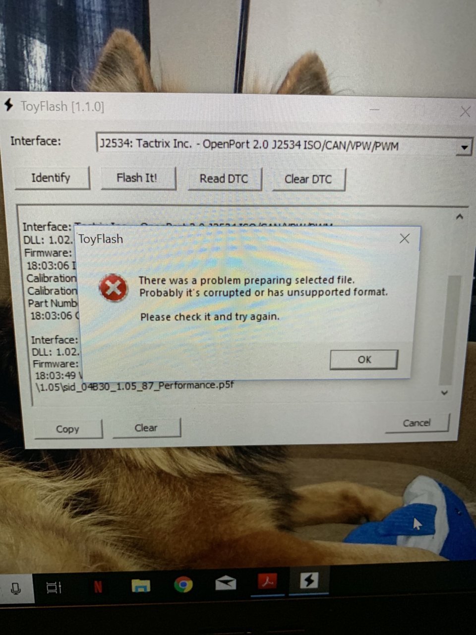

    If you have a tactrix cable make sure you select the dongless option in the first drop down box.
