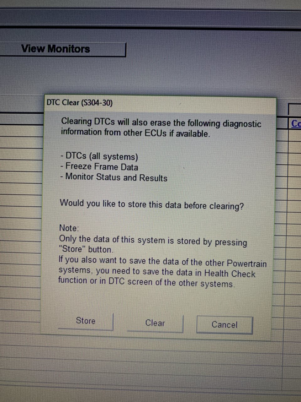

    Ok pretty sure when you clear DTCs for Engine/trans it also clear fuel trims and trans memory as clearing the Dtc clears freezeframe data as well as ‘monitor status and results’
    But feel free to do it the other way. I did both ways.

    It will work only as Mat programmed it to work. I believe Techstream has been programmed to do more...Im saying this based off my experience of using it, doesnt mean im right . Just do both methods via Techstream it will not hurt anything.41CB3B65-026E-44A8-B352-35DD83B2908D.jpg

    No battery disconnecting as that doesnt do anything. Just flash your truck and then clear DTC for both engine and trans. Let us know if its still rough. If it is then clear fuel trims and trans memory via techstream the way everyone else has been doing it.
