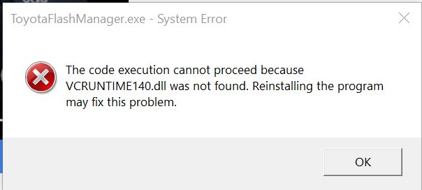

    Go ahead and roast me for not following instructions, but I cannot get the flash manager to work.
    I downloaded and installed via the link in the first post.
    Installed ok, but when I went to open gave the following error:
    I thought, well maybe it needs the registry file from Matt to work, so I installed that. Still fails.
    I find the instructions quite confusing and fragmented, any help on what is probably a simple fix?
  6. Mar 10, 2019 at 1:32 PM

  7. Mar 10, 2019 at 1:32 PM
    Shellshock
    Nov 21, 2015
    #170338
    23,409
    Iowa
    Get the download from the first post.
    SpeySquatch likes this.
  8. Mar 10, 2019 at 1:40 PM
    rdpoe
    rdpoe #2WDFTW
    May 28, 2018
    #254789
    1,733
    Central Kentucky
    2019 TRD OR DCLB (Sold), Honda Civic TRD PRO
    No dice. That what I did the first 3 times, then I tried from the link to the post Matt sent me with my registry file and I just tried it again, just now, from the first post.
    I'm also uninstalling between every install of the flash manager.
    Tacoma816 likes this.

  11. Mar 10, 2019 at 1:58 PM
    rdpoe
    rdpoe #2WDFTW
    May 28, 2018
    #254789
    1,733
    Central Kentucky
    Yep, Quoting myself.
    I dug around a little. Seems like there is an error in the installation of Visual C++ with the OVTune Flash Manager file.
    I downloaded Visual C++ separately from Microsoft, and unchecked it when installing Flash Manger.
    This seems to have work.
    Just wanted to give a heads up!
  12. Mar 10, 2019 at 2:01 PM
    Iceman_JD
    Iceman_JD RIP Nicky
    Jun 18, 2017
    #221822
    41
    John
    Phoenix Az.
    2017 Tacoma off road
    Magnaflo catback exhaust, K&N cool air intake, Xenon Headlights, Led high beams, Led yellow fog lights, Gentex rear view mirror with homelink auto dimming and compass, TRD Pro Tail lights, TRD front Grill, side steps, Led backup lights.
    I had the same problem try using this file from microsoft.
    https://www.microsoft.com/en-us/download/details.aspx?id=15336
    It's an older files but it worked.
    Venator_2033 likes this.

  14. Mar 10, 2019 at 5:49 PM
    frito-frio
    frito-frio Well-Known Member
    Nov 14, 2018
    #272677
    46
    Gregg
    Nashville Tennessee
    Black 17 Off Road
    2017 Off Road 3" Lift, KMC XD wheels, 305/70r16 KO2 tires, 4.88 Nitro gears, ADD front bumper, Body Armor rear bumper, 9.5k Rough Country winch, Leer shell, OVTune 1.04R
    I had the same issue with the 64 bit package. I downloaded the 32 bit package and it worked fine. (I have a 64 bit OS)
