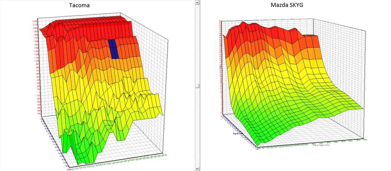

    I originally didn't want to post it when I figured out how to dull the stutter... it's without a doubt the worst looking ignition map I've ever seen from a stock car. Yes that's stock.
    I just ask nobody goes to the dealer and says "this guy online says your ignition looks like shit!"
    blue is just where the cursor was on the map. that's all.

    Man I wish I could read that graph, I see engine RPM along the bottom, engine load along the side, but what are the green > red?

    Looks like a 3 yr old got a hold of the crayons. Do you have any theories on what they were trying to accomplish with the unconventional ign map? I just can't see a major manufacturer doing something without having a reason for it. Makes no sense. I come from BMWs and their tuning is silky smooth at all loads and rpms.

    Likely degrees of ign advance.

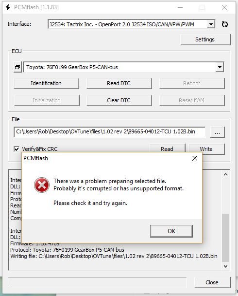

    Is anyone else having trouble with the gearbox file? PCM Flash says mine is corrupt or in the wrong format.

    fixed and sent.

    Got it! Thanks Mat!
