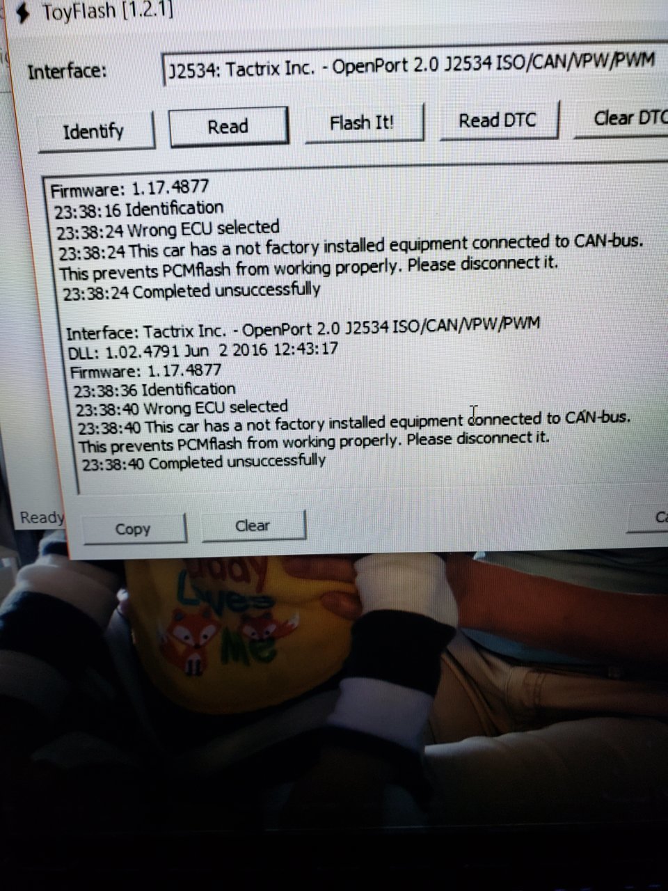

    Trying to flash performance tune and keep getting flash unsuccessful. Battery at 12.7 and lap top is updated. Never had an issue before. Any thoughts?

    Forgot to add, did just recently get new radio but I disconnected the obd connection that the maestro has

    Tried just reading ecu I'd and get this. Could it be the radio. Like I said maestro is connected to obd connector but just pulled out and plugged tactrix.

    What do you currently have loaded? 1.05 is read locked

  18. Mar 21, 2019 at 9:16 PM

    Clear DTC. Try to flash again

    I don't think it blocks u from reading, just doesn't show anything other than ecu id, ie 04b,04

    Did that
