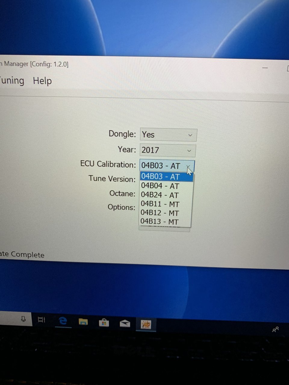

    This is my first time tunning. How am I supposed to know what Ecu I’m running if that’s one of the last steps? Which is to go to your vehicle. That’s what I’m trying to say.
  4. Mar 22, 2019 at 9:40 PM
    KrnTaco08
    KrnTaco08 Well-Known Member
    Jan 1, 2017
    #206241
    1,863
    LA
    2017 Taco
    I’m stuck right here. How am I supposed to know what to fill out?
  5. Mar 22, 2019 at 9:41 PM
    nxcess
    nxcess Well-Known Member
    Oct 16, 2014
    #140482
    351
    '17 Tacoma MT 4x4
    OVTuned
    That's what the video is for. To help with situation like this.

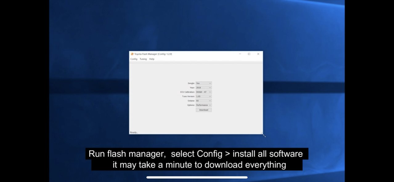

    I understand. But in the beginning of the video it already shows what I’ve been trying to fill out “filled out already”

    We can take you to the water, but we can't make you drink it.. Watch the link I posted. It starts where you are stuck. All you need to do is use P5Flash to identify the ECU and you'll have the ECU ID.

    Ok thanks. Not trying to start anything and I appreciate all you guys input. Maybe it’s miscommunication but this is what I’ve been trying to say about the video.
    It was already pre filled when it came on the screen around 58secs.
    Anyways, I’ll figure it out. Thanks.

    You need to install Flash manager - Don't worry about ecu or that menu with drop down tabs that ask you questions. Just install FM then install all software, then update. You can then connect your laptop to your truck with the cable you got with you OVTune kit. pf5flash is part of the software you installed. After you get connected you will open Flash manager and then open p5flash and click on the identify button. That will tell you what ecu you have installed.
    At that point you can ask your next 100 questions. Don't get frustrated and don't get disappointed. You will get it done.

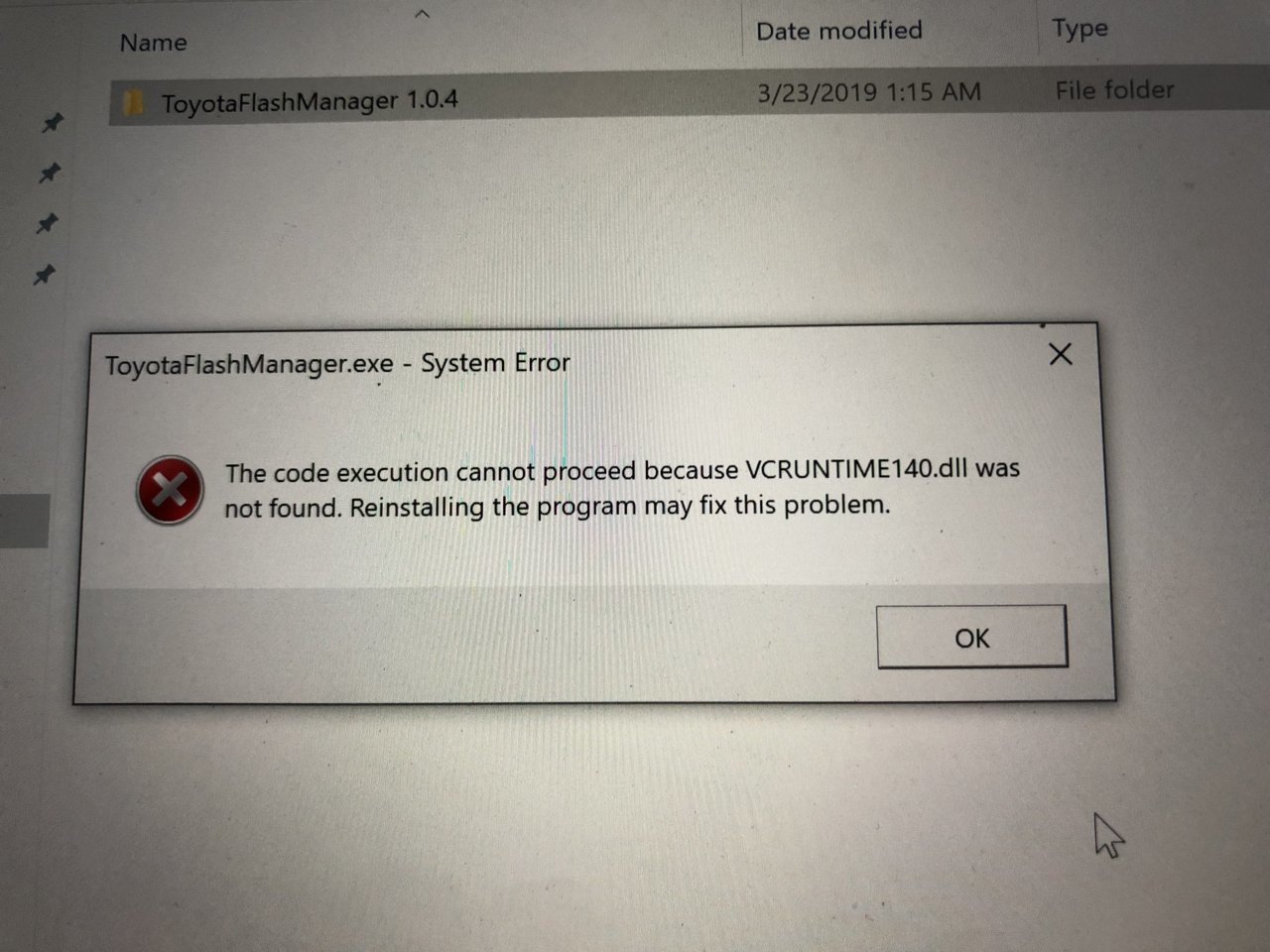

    I’ve tried uninstalling and re-installing both x86 and x64 several times, and keep getting the same error message immediately after the installation. Saw that someone in the group recently encountered this, but I didn’t see a fix. Can anyone help? Thanks!
  20. Mar 23, 2019 at 11:47 AM
    rdpoe
    rdpoe #2WDFTW
    May 28, 2018
    #254789
    1,733
    Central Kentucky
    2019 TRD OR DCLB (Sold), Honda Civic TRD PRO
    This will fix it
    https://www.microsoft.com/en-us/download/details.aspx?id=48145
    RocRan26 likes this.
