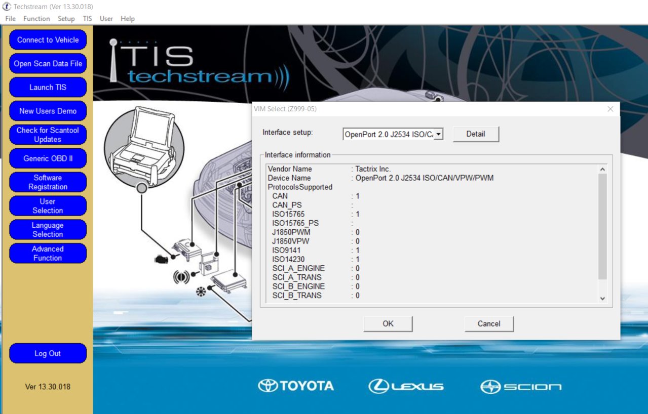

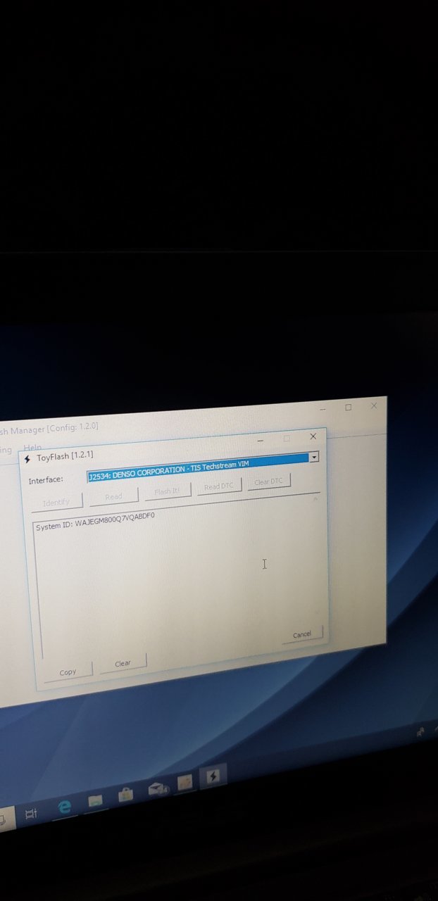

    20190323_134553.jpg we are in my truck, downloaded registration key, can't click on any of these? Help.

    Got it! But, Now it is not reading the truck??

    The interface is not correct

    Trying to make techstream work now. Don't seem to be connecting with truck.

    Are you selecting the Open port under the setup drop down?

    Yep. Click Setup > VIM SELECT and choose openport from the dropdown like @disk_55FL showed.

    trying to indentify my truck (first time) and keep getting a "toyflash has stopped working" error and have to close it. ran a search and did not find anything.

    Did you "install all software" and install the openPort (Tactrix) drivers? Disable antivirus and/or windows defender?

    ^^^^ got it... I corrupted the drivers somehow. Short trip around neighborhood and liked how it drove. Couple day ski trip up in the mountains so see how is does.
