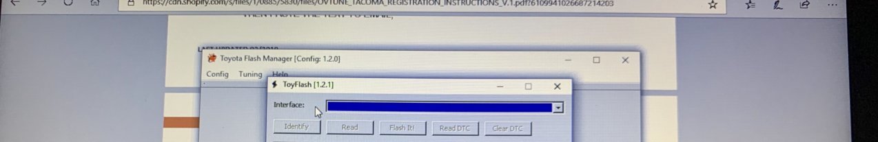

    On Toyflash to get the system ID everything is blanked out. In the instructions it’s not. There still a System ID though. Just wondering if I should be concerned . I sent the email with the system ID I saw. Just tripped me out because of the difference.B0A87AC0-2367-4121-899F-2974B50C567A.jpg

    It’s blanked out cuz you haven’t finished the setup yet.

    I downloaded the drivers so I don’t know what part I haven’t finished.

    Registration
    Also I think you have to plug in the tactrix cable before it shows up in that field.
    rainyben45[QUOTED] and PapaRee like this.

    So in order for all the tabs to be available I have to have my registration key already programmed in ?

    Yes. Until you get your kit and plug in your cable, that will be blank.

    You are as far as you can go without your kit. Everything will be easy and fast when you get it and your registration key.
