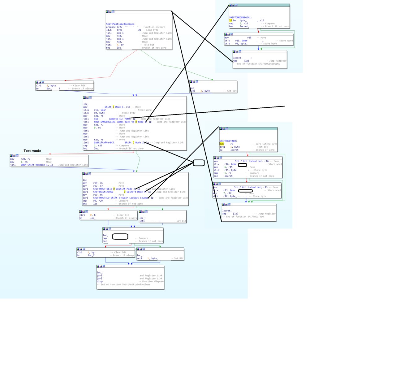

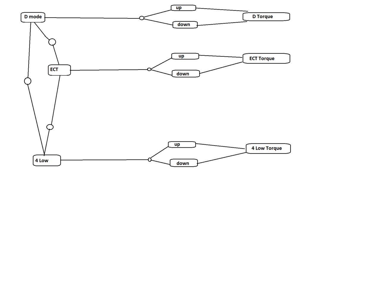

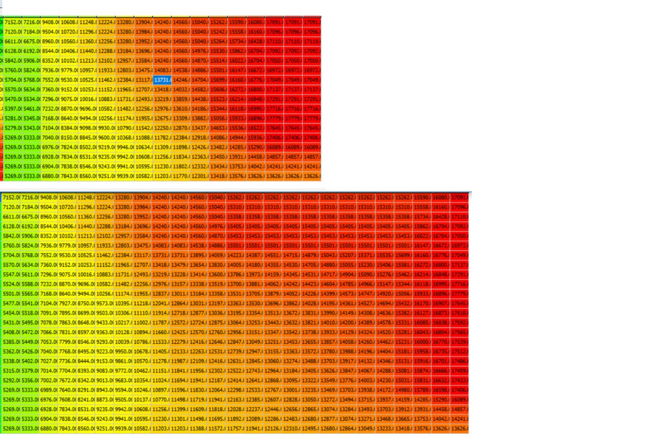

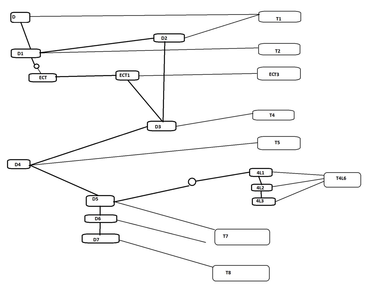

    Testing begins in April for our new EROM 1.06 patch.
    - Should be available by end of summer / early Fall 2019.
    Modifications to EROM -
    I think this is going to solve every...every problem left with the transmission.
    - Complete redesign of the entire shift control. From the ground up.
    - Dedicated Upshift and Downshift tables for drive modes With unique Downshift Tune features (TBD):
    D > Singular
    ECT > Singular
    4Low > Singular
    Modification to Shift table size allocation >
    Stock x13
    EROM > x16
    Modification to shift Torque size allocation >
    stock 17x17
    EROM > 25x25
    Revision of stock code to EROM shift code (see below graphs and code generation of OEM)
    Many more features are also being incorporated. This sums up only what's being done to some of the transmission.
