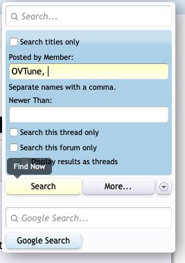

    @OVTune not necessarily tune related... BUT how about a notification email to announce aforementioned updates? Maybe your site already has an RSS feature that I am unaware of, but having to keep coming back to this thread to check the status cannot be the optimal solution.
    Maybe the answer is a separate thread that only you are allowed to post in. We could then subscribe with notifications.

    Yes it does. But you missed the part of alleviating the requirement of visiting this dumpster fire thread to find out if there has been a new release.

    And this little arrow:
