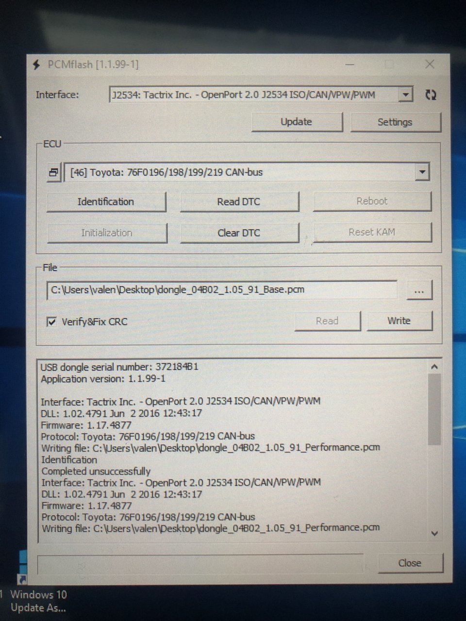

    Already updated the ECU file Opened the PCM flash attached the performance file clicked on “write” and it appeared “unsuccessfully”

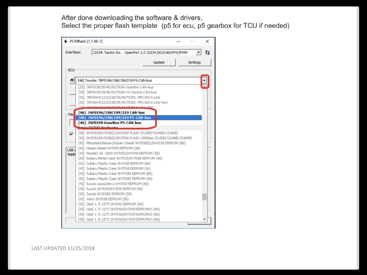

    Change to p5 can bus

    Thanks I already did that and same problem

    Do you have a head unit that pulls odb data? If so you have to disable it
    Also can try clearing dtc then flashing again.

    I deleted techstream and others files that came with the techstream.. plugged it and it did work!!
    Have the performance file! Will compare the performance vs base and gearlock.
