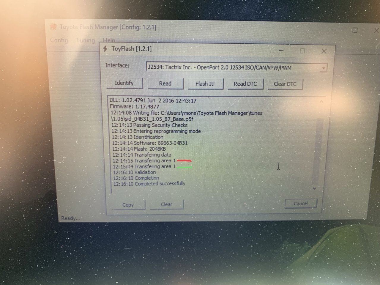

    Maybe you never flashed anything. You have to go to your download folder or where-ever you put your downloaded tunes and chose one for p5flash. It will ask you to chose a tune. Then you click flash it and sit back and watch the progress take place. Then you will get a confirmation. BTW - I think your doing great! Keep at it. :thumbsup:

    Fyi if you get get an error box, says something like “error flashing software” or something along those lines, just try to reflash the ECM. I’ve had it happen before. Second time tune takes.
    The red line it didn’t take. Green line it did.
