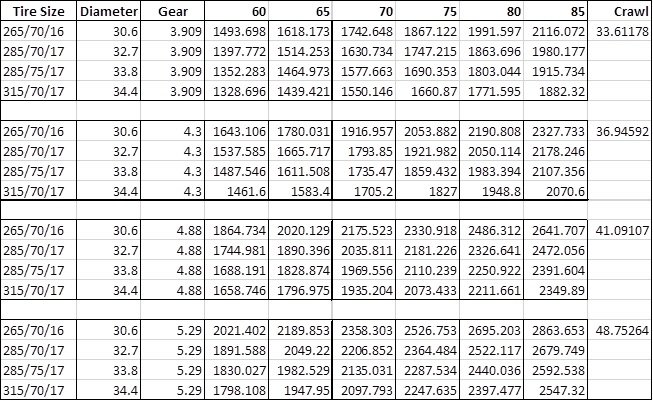

    When traveling slightly uphill while holding throttle sometimes at 30-40mph on avg the truck feels like it’s starving for gas so it drops low in the rpm range and will hold that gear (usually 4th). This engine is basically sipping fuel like a queen sipping tea, so in turn the engine stutters. The gearing is high for these trucks as well.
    Look at the 3.9’s and think 45mph instead of 60
    Hence 4.88’s

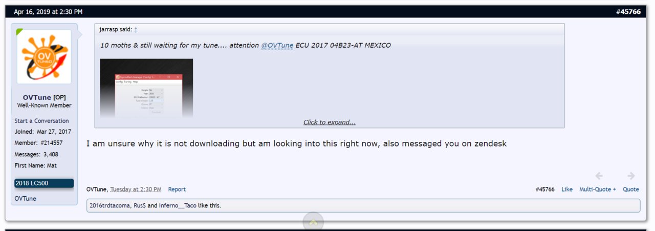

    jarrasp
    jarrasp Member
    Dec 4, 2016
    #203974
    21
    17 special edition tacoma
    Yes, I bought the tune on July 2018... at July 29 2018 I got the Reg Key and a useless tune at Aug 18 2018 & no other tune before it....
    At the date this is OVTune response & I still waiting ....
    "" IT IS IMPORTANT TO MENTION THAT I AM POSTING THIS SITUATION HERE NOT BY DISTURBING ANYBODY BUT I HAVE RECEIVED VERY BAD ATTENTION FOR A PURCHASED SERVICE ""

    OVTune
    OVTune [OP] Well-Known Member
    Mar 27, 2017
    #214557
    8,112
    OVTune
    Yes as posted we are working on trying to figure out what the problems are. Your ECU version is unique and only 3 trucks out of all of them we have ever seen has it. And 04B24 there has only been 1 truck ever.
    99% of the waiting time was because of the transmission programming that we were unable to get around because we have no possible way to test anything because the ECU version is extremely rare.
    The file we sent you wasn't useless it was to confirm it would even program and the transmission would still shift. After that, putting our TCU tune into it the truck would again not shift. It has taken us months to figure out why.
