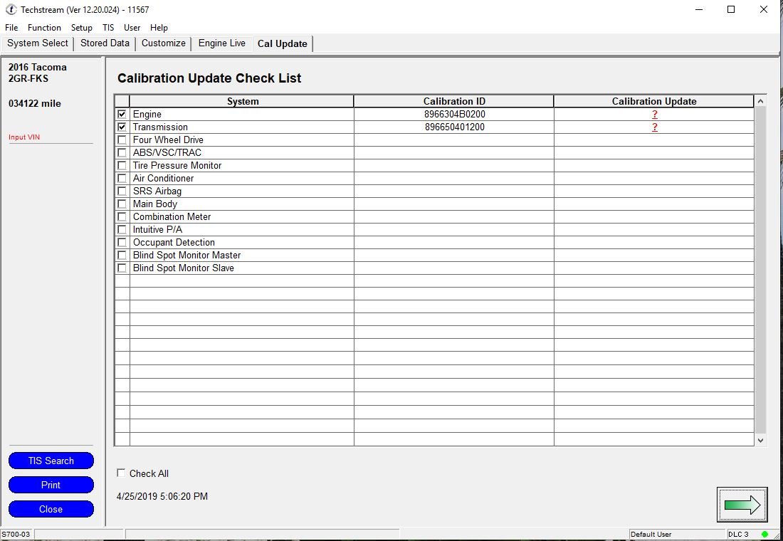

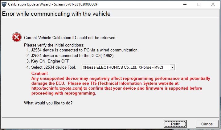

    Here's the error. You can see in the second screen shot that I have no trouble connecting through tech stream but get the error when executing T-0034-18.cuw

  12. Apr 25, 2019 at 3:22 PM
    Venator_2033
    Venator_2033 Well-Known Member
    May 12, 2017
    #218844
    131
    4" inch lift Dakar leafpacks/Bilstein 5100 B110/Fox 2.0 coil-overs/Catless Dual Exhaust w/H-pipe/OVtuned1.05/RCI Sliders/HID kits Hi/Low/AFE Intake with scoop and 76mm throttle body/Total chaos Fab UCA's
    In the drop down menu for selecting which J2534 device tool you need to select open port 2.0 which is your tactrix adapter and then should be good to go.

  13. Apr 25, 2019 at 3:22 PM

    Jul 26, 2013
    #109078
    1,636
    Dave
    Southern California
    '17 Tacoma 4x4 off road DCLB
    Change #4 to tactrix

  15. Apr 25, 2019 at 3:42 PM
    FritoBandito
    FritoBandito Well-Known Member
    Sep 26, 2015
    #165230
    400
    Texas
    2016 Limited 4X4 DCSB
    Thanks for the quick reply but I don't have a tactrix cable and it's not an option in my drop down menu. I don't have the OV Tune kit yet but am getting ready for it by applying the TSB first. Bought a cable off Amazon that works fine for everything but for some reason I'm not able to apply the TSB. GTSAPI_TGD.EXE got quarantined by McAfee during the TS install and I'm going to try to move it out of quarantine and back into the file system and see if that helps.
  16. Apr 25, 2019 at 3:54 PM
    Venator_2033
    May 12, 2017
    #218844
    131
    I wouldn't use that cable to flash the tsb as you could brick your ecu, if you've already bought the kit and are waiting for it to come in the mail I highly recommend to just wait till then that way if something goes wrong you can unbrick the ecu yourself.
