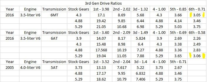

    They go with the 5.29 and 33s because even with STOCK tires, switching to 5.29 put it at about the same rotation as the manuals. I believe with the proper tuning they'll run very nice. Which is why I have a set sitting in my garage but haven't swapped over yet since I wanted to wait for the gearing specific tunes.

    Not in the manual, but with the AT some guys (@JoeCOVA) are reporting the 5.29’s are surprisingly drivable even with stock tires...

    am I wrong that regearing should be based off of 1st gear thru direct 1 to 1 gear (in this case 4th )
    Regearing to use over drive and double overdrive is wrong . Just use 4th and maybe 5th gear if using taller tires .
    If the tires are so tall that 1 to 1 gear is wrong , you need to regear .
