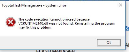

    I think it needs the 32-bit version, even if you are running a 64-bit version of Windows. I got this error, even after installing the 64-bit version, and it was resolved when I installed the 32-bit version.
    KrnTaco08 likes this.
