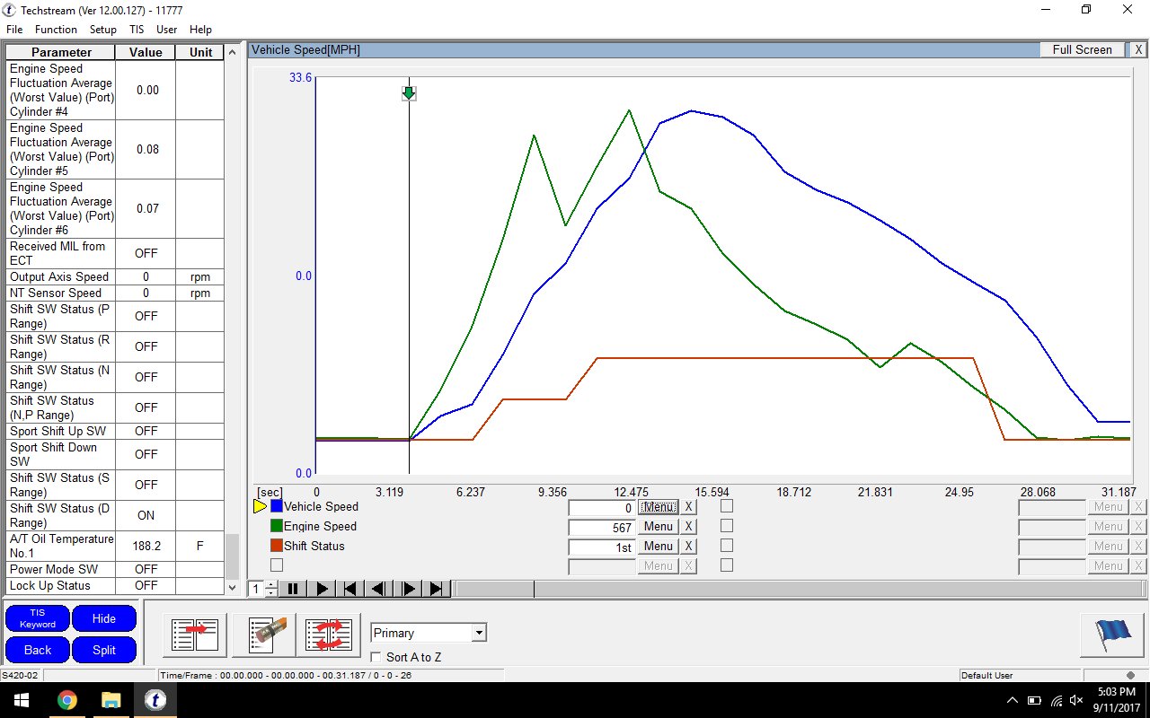

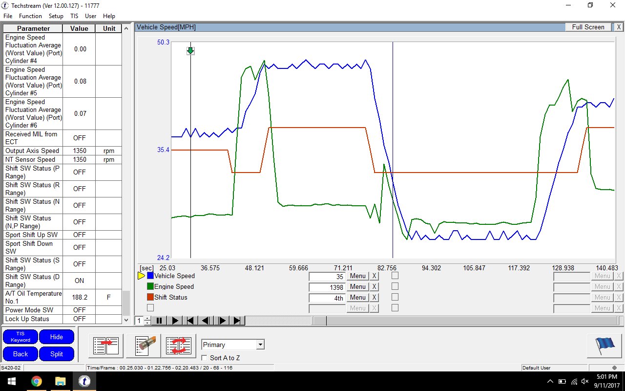

    Interesting, it counts going from 6th to 4th as one change, but going 4th > 6th it goes through 5th. Perhaps this transmission can skip straight to a desired gear.

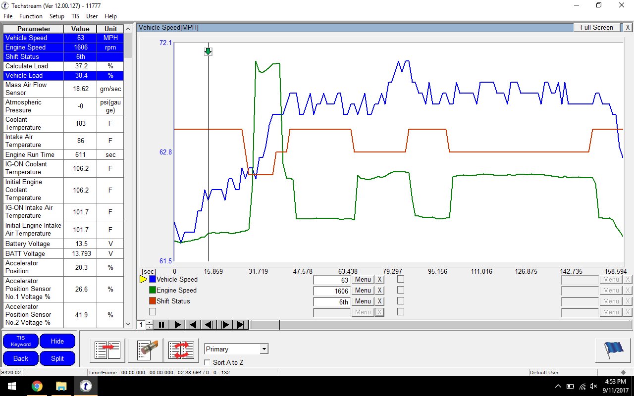

    Also not understanding the graphs but I like where this is going.

    Green is engine speed, blue is vehicle speed, brown is gear selection. Read the box on the bottom for which gear is selected where the vertical line is and follow it.

    Add throttle position to the graph as well so we can see the delay from pressing throttle to getting a gear change

    Ok I'll try to get to that. Everything can be added to those graphs.
