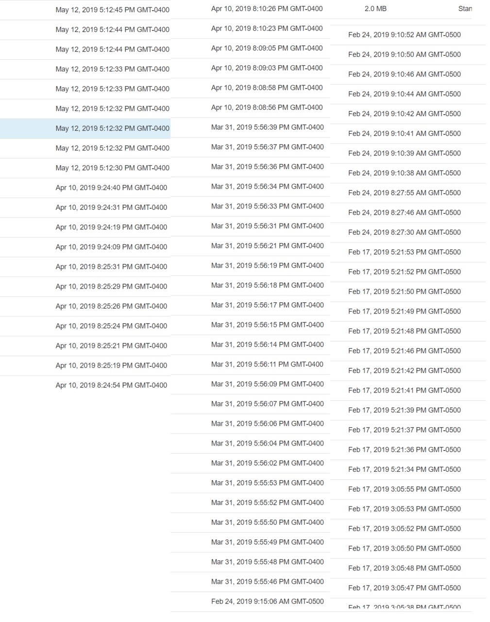

    Note... regarding "timely updates"
    Here is our file dates by update.
    Updates in December > begninning of January, Feb 17th, Feb 24th, March 31, Apr 10, May 12....
    We absolutely listen to you guys and update as fast as can be done.
    To put it into perspective When a major update is pushed out, it's 250 files at a time.
