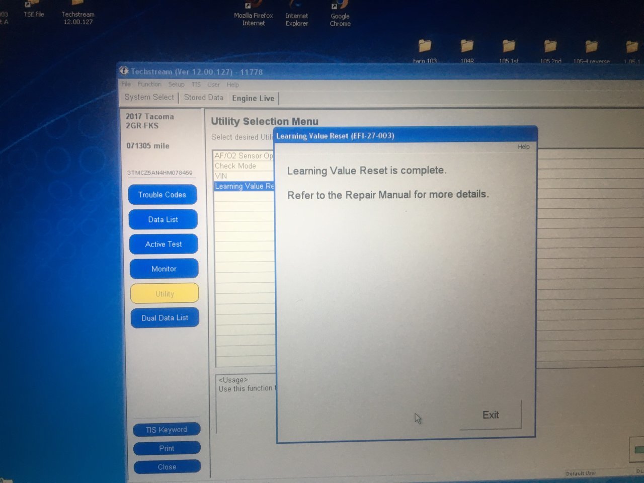

    Dongle users can use tech stream.
    Go to
    Engine
    Utility
    Learning value reset

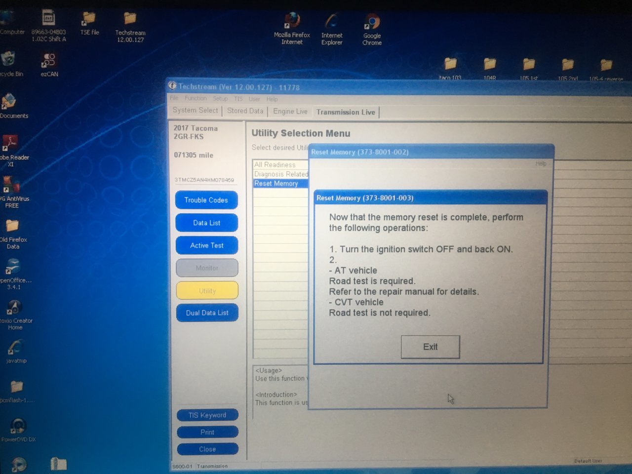

    Then
    Transmission
    Utility
    Reset memory

    Note: I did reset learned values at both the ECU and TCU via techstream (dongle here) and the truck shifted awful for the first 20 miles or so. Throttle was also wonky. Don’t be alarmed, it goes away quickly after the ECU and TCU start learning values again.

    Believe that happens because the learning process doesn't start until the engine coolant temperature is at 176*
    Once that is reached, there's a idle learning procedure to follow that's in the tech manual. I've posted that somewhere in this thread back in the days.
    I've noticed that if you don't follow those procedures, throttle is wonky and dangerous if you're pulling into traffic.
    The next time I did a reset like that, I followed those procedures and did not have the crazy wonky throttle.
