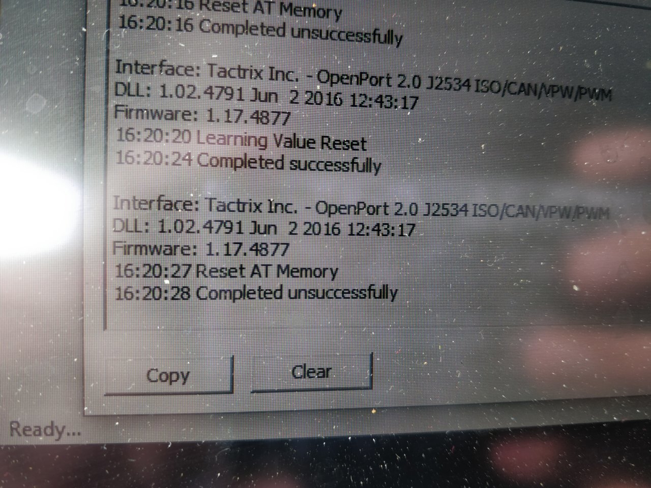

    Hi All,
    Anyone knows why I would not be able to clear AT..?
    See my picture, I can do the LV successfully.
    Thanks

    Try turning truck off and back to ignition with engine off and try again
    dialfonzo[QUOTED] likes this.

    Thanks - I'll re try that as I did once already

    It worked this time, I guess it's best to restart the truck and software if that happen.
    Thanks again
