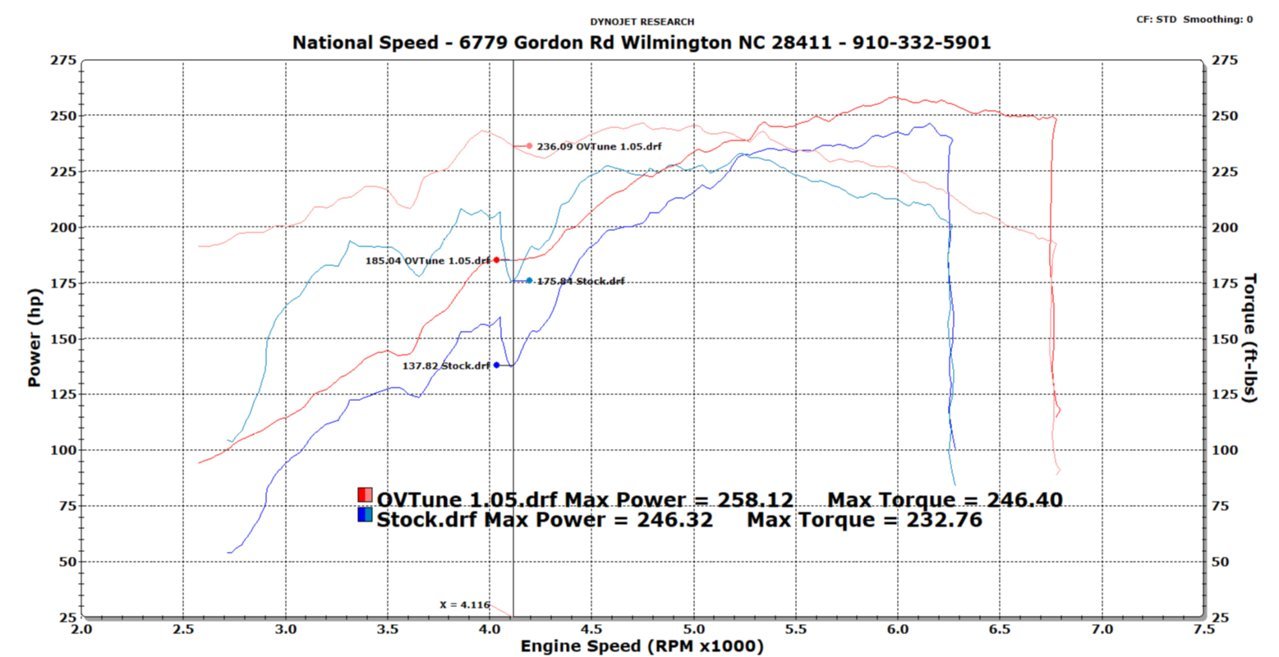

    The peak hp increase is roughly +12hp at around 6100 RPM -- which is mostly useless for normal driving situations.
    However, the differential along the curve ranges from +20 to +50hp, depending on RPM -- which is extremely useful in normal driving situations.
    The same is true for the torque improvements along the entire curve.

    Totally agree...many people don't realize that peak hp at high RPM is pretty useless for everyday driving. We might as well start talking about who go laid on prom night.
